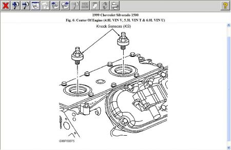

Can someone tell me where and how difficult the knock sensor is to get to and replace (cost is about $42)? Also is there only 1, or 2 on this model truck?

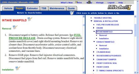

Mr. Bob
What's your engine liter? am coming up with 2 KS for a 5.3 and 6.0 located in the valley under the intake manifold-see below
KS's
http://www.2carpros.com/forum/automotive_pictures/12900_ks_1.jpg
Intake Manifold Removal
http://www.2carpros.com/forum/automotive_pictures/12900_intake_manifold_1.jpg
