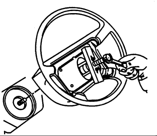

TOOL REQUIRED:
J 1859-A Steering Wheel Puller Or Equivalent
REMOVE OR DISCONNECT
1.Negative battery cable.
2.Disable the SIR system (if equipped). See: Air Bag(s) Arming and Disarming Service and Repair
3.Inflator module. See: Restraint Systems Air Bag Systems Air Bag Service and Repair
4.Horn contact (if equipped with SIR). See: Lighting and Horns Horn Switch Service and Repair
5.Horn pad assembly (if not equipped with SIR). See: Lighting and Horns Horn Switch Service and Repair
https://www.2carpros.com/forum/automotive_pictures/12900_s1_6.gif
6.Steering wheel nut. Notice the alignment mark and its relationship to the steering wheel and steering shaft.
https://www.2carpros.com/forum/automotive_pictures/12900_s2_5.gif
7.Steering wheel using J 1859-A.
CAUTION: Do not hammer on the puller or damage could result to the steering column.
