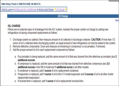

How much new refrigerant oil is added to a new a/c condenser during a R & R?

To better assist you is your vehicle model a C1500, C2500 or C3500 and I need the exact engine size in liter and the 8th digit of your VIN.

Engine size is 5.7 L, 8th digit of VIN is "K" Condenser has never been replaced.

What amount of oil, if any, is required for the new a/c condenser?

C1500

I apologize eddotsato as I go through the chart it asks for the 4th then the 5th digit also as it goes to body code, then series code. To save time would you please provide the entire VIN

VIN number is: 2GCEC19K0P1218123

Hello eddotsato
The information you requested
http://www.2carpros.com/forum/automotive_pictures/248015_Picture4_10.jpg

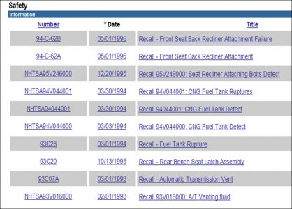

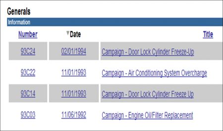

Just as a note - after I had sent you the information I did some other looking. You may have some recalls on your vehicle. The dealer may fix these for free. Please contact the dealer service department, give them the VIN number of your car and have them check on these to see if they apply to you.
http://www.2carpros.com/forum/automotive_pictures/248015_Picture9_6.jpg
http://www.2carpros.com/forum/automotive_pictures/248015_Picture10_7.jpg
