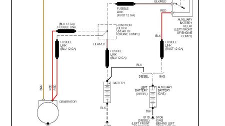

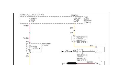

I am still having problem however. Today I pulled my alrenator and had it check at auto zone. It passed! When I put it back in my truck however the charge at the alternator (volts) only read what the battery was putting out, no more. As thg truck ran and the battery deceresed so did the voltage at the alternator.
There is a small boot that raises concern to me. On the back side of the alternator there is a slot with four small prongs. I only have one wire connected to the larger of the 4 prongs. The boot has been lost. Should I look around for a boot which could accomodate all four prongs? The wire I have hooked to the large prong currently is providing power. Do you think a specific 4 prong female boot will "excite" the alternator enough to have it release a current?
If the alternator test good at auto zone, then its working. Why isnt the charge being delivered to the battery?

Review below charge system EWD
http://www.2carpros.com/forum/automotive_pictures/12900_c1_13.jpg
http://www.2carpros.com/forum/automotive_pictures/12900_c2_10.jpg

Thanks once again for the schematic Rasmataz!
Im still having a dilema in finding the proper harness connector for the brown wire. The alternator (delco/remy-100 amp) has a female port with 4 male field prongs. I only have the one brown wire hooked to the larger of the 4 prongs. I need to purchase an adapter to compensate all 4 prongs.
Would you know where I could find one? Is there a special type I need or can I by a generic one that will fit. Ive looked through the internet, autozone and napa and still cannot find a specific adaptor.
Thanks again, Im going nuts here!
