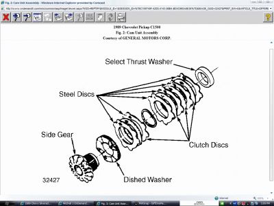

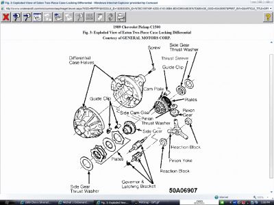

My rear differential has crumbled, and I need to know how to put it back together. HELP!
Tuesday, January 8th, 2008 AT 1:53 PM
MERLIN2021
MECHANIC
17,250 POSTS
There is more to these than meets the eye! Here are both types
