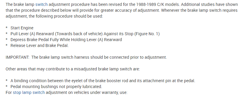

I checked with a voltmeter. I have current going to the lights. Current travels through the switch. I checked the fuses under the steering wheel in the box next to the hood release. Is there another fuse I need to check? And there is no power going to the brakeswitch. I have broke my turn signals where they work if I hold it. They will work to the left. But idk if the brake lights have a short before the switch or if there is another fuse to check or what? Any advice?

Brake switch fixed it.

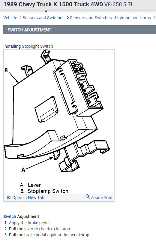

The brake light switch is located on the brake pedal bracket.
When the brake pedal gets depressed the pedal pushes against the brake light switch and the brake lights illuminate.
See diagrams below for helpful information.
