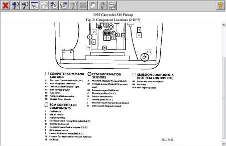

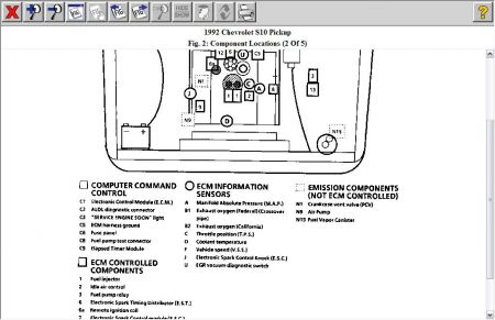

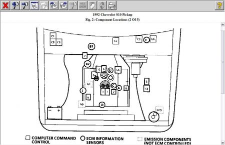

Where is the oil presser sending unit located? Also what is the relay to the left of the fuel pump relay? I have a wiring diagram but none of the wires match up for this relay (2 solid green wires, 2 green w/ white stripe and a pink with a black line. I did some more checking today and on the fuel pump relay should I have power on the green w/ white stripe with the switch in the on position?
Gray wire feeds the pump and no power with the switch on. Many thanks.
Sunday, September 30th, 2007 AT 4:27 PM
  • 75,992 POSTS
The oil pressure switch is on #8 see below
https://www.2carpros.com/forum/automotive_pictures/12900_1992_Chey_S10_Oil_pressure_switch_1.jpg
Fuel pump relay at #3
https://www.2carpros.com/forum/automotive_pictures/12900_1992_Chevy_S10_Fuel_pump_relay_1.jpg

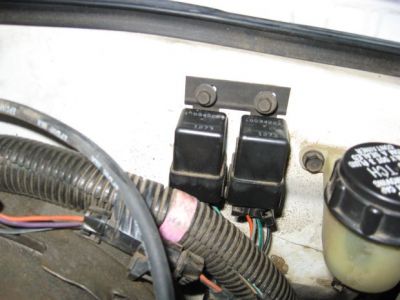

Heres a photo of the relay in question. The one on the right is for the fuel pump but what does the one on the left controll?
Thanks
https://www.2carpros.com/forum/automotive_pictures/103149_Relays_2.jpg
Monday, October 1st, 2007 AT 3:36 PM
  • 75,992 POSTS
The one beside the FP Relay is the AC relay.
