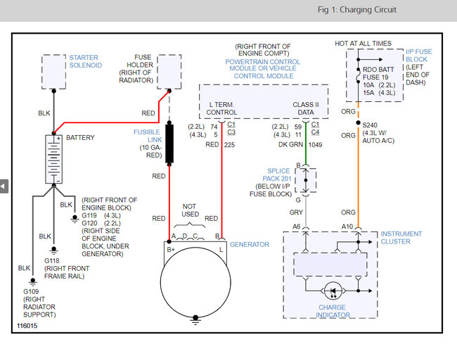

I was helping my dad replace his alternator on his 99 Chevy s-10 yesterday and we had some confusion on the wiring connections on the back of the alternator. There are three wires down there. I know the one with the rubber boot is secured by the lock nut, but where do the other two go. We got everything connected once, and when we tried to start the truck it would not, so we pulled everything back off and saw that we had a wire connected wrong. Once that was connected correctly, the truck would start. However, it will not charge the battery at all. Is there something we have wired backwards or could it be the battery. We are stumped at this, and we are trying to get it fixed ourselves versus a repair shop.

Hi, my info showed this for S10 four cylinder alternator wiring diagrams with a guide to help you test it
Check out the diagrams (Below). Please let us know what you find. We are interested to see what it is.

Thanks, so it looks like from that diagram we have everything hooked up correctly. I took the battery and had it charged today, now the gauge is showing 12 volts on the dash. However, it does not move up any further while I had the truck running.

Engine running, take a reading at the alternator bat terminal. What is the reading?

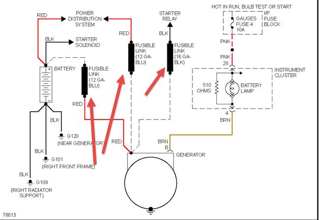

My S 10 has a new battery and a alternator that checks out at Autozone as charging. All connection are good and clean plus tight. From what I have seen everyone is saying to check the little brown wire that plugs into the alternator for a breakage or bad connection. That is if the vehicle has a light for the battery on the instrument panel (gauge cluster). Well mine has no light at all in has a volt meter gauge. Do you still check this in the same manner as the light? And does the charging system go through the the PCM to command the alternator to put out?

check the three things in pic that I have pointed out and yes still check the brown wire for a bad connection. but the fusible links should have same voltage both sides and not just one or two strands connecting them
