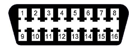

I cannot retrieve any codes from the computer. Engine was running fine and started to miss. I did not get a check engine light but I connected my code reader and did not get any response from the control module. The code reader works fine on my other vehicle.

https://www.2carpros.com/forum/automotive_pictures/170934_obd11_3.jpg
With the standard obd11 datalink connector, pin 16 is battery voltage, hot all the time. Pins 4 & 5 are grounds. Are you using an obd11 code reader? If your missing voltage on pin 16, maybe we can track it down?
How long since a tune-up, have you done any basic testing? Check for spark at the plugs, check fuel pressure?

I am using an obd11 code reader. There is no voltage on pin 16. Pins 4 and 5 are ground.

Check the cigar lighter fuse and circuit.
