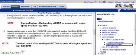

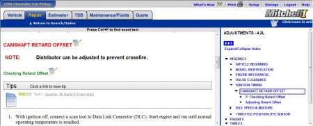

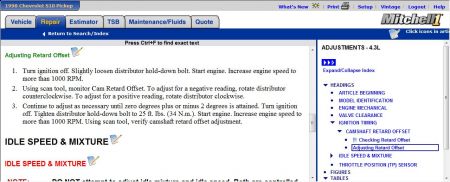

i just had intake gaskets replaced and now I have starting problems like a kick but ran down road good. Can you adjust the timing with the distributer like on older cars and does this sound right?
Thursday, March 11th, 2010 AT 11:45 PM
MECHANIC
75,992 POSTS
The ignition timing is computer controlled.
Friday, March 12th, 2010 AT 1:42 AM
