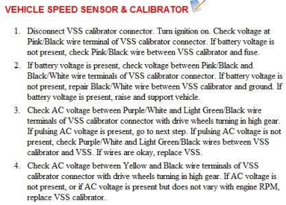

My shift light stays on but my speedometer doesn't work. I have replaced my speed sensor, a bad wire, the ECM and the dash cluster. None of these worked and I was wondering if it may be the VSS buffer and where its located.

Follow steps below to pinpoint culprit .. the VSS buffer is behind rightside instrument panel..
https://www.2carpros.com/forum/automotive_pictures/261618_Noname_2260.jpg

Where behind the right side instrument panel exactly is it? Under the ECM, behind the rightside kick panel, or behind the dash cluster, or what does it look like?
