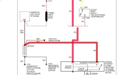

Truck has been running fine, one day it will not start.
Battery tested full charge. When attempting to start,
there is no sound at all from starter. Lights do not
dim and all dash lights are on. All wiring seems to be
in place.

Get a helper to hold key at cranking position tap on the starter if it engages the engine replace the starter. If not check for power on the purple wire no power the problem is coming from the ignition switch there's no neutral safety switch in between
https://www.2carpros.com/forum/automotive_pictures/12900_start1_2.jpg
https://www.2carpros.com/forum/automotive_pictures/12900_start2_2.jpg
