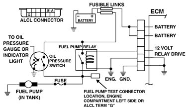

I have the 4.3L version of the 6 cyl with the TBI. I am not getting fuel on the initial start. If I put starter fluid in the ports the truck will start and continue to run. I can see the gas in the ports after it starts. I have replace the fuel pump relay, fuel filter, MAP, temp sensor, PCV valve, and all the old vent lines. The fuel pump is working and there is spark. I am not getting the initial 2 second surge of fuel when the key is placed in the on position. Any ideas of what to try next?

The computer energizes the fuel pump relay for that 2 secs time. when the engine fires up the oil pressure sending unit takes over the power for the fuel pump
see below
https://www.2carpros.com/forum/automotive_pictures/12900_oil_sending_unit_and_fuel_pump_circuit_59.gif

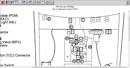

Check the inline fuse 20amp, and fuel pump relay is at no. 3 below
https://www.2carpros.com/forum/automotive_pictures/12900_fp_relay_14.jpg
