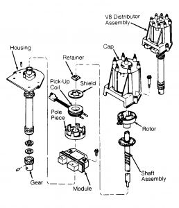

Hi
Is engine a 4.3L ? if yes suspect Ignition Control Module inside DIST see diagram
https://www.2carpros.com/forum/automotive_pictures/198357_Graphic_662.jpg
Can have checked out at Auto Zone.
Let me know

It's not ignition
