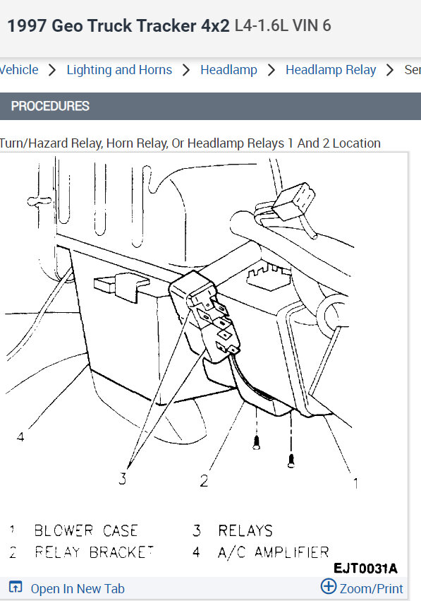

I can not find headlight relay in my 97 geo tracker, could you tell me where under the hood it is located

The head light relay No1 & No2 are located behind the glove box according to the data available to me.

Sure the headlamp relay is:
RH I/P, behind I/P Compartment in front of Blower Motor
Check out the images (below). Let us know if you need anything else.
