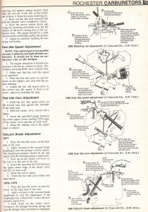

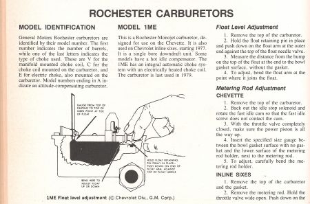

Ok guys thanks for the info so far. Last night I tried putting a guage on the fuel pump. Well I have about 5 lbs going to the carb. Atleast I elminated one problem. Next I wanted to say the carb is a rochestor, I think quadrajet makes it. I guess I'll try moving up to the carb now and pull the jets as someone suggested. Does anyone know about how many turns it should be out so I can compare to where I'm currently at. Thanks again.

Here are a couple of reference pages to look at. if you are going to rebuilt the carb get a rebuilding kit. it will come with what you need and instructions and guages for the float level
let me know how you make out
https://www.2carpros.com/forum/automotive_pictures/54223_rochester_carb_1977_1.jpg
https://www.2carpros.com/forum/automotive_pictures/54223_rochester_carb_1977_1_1.jpg
