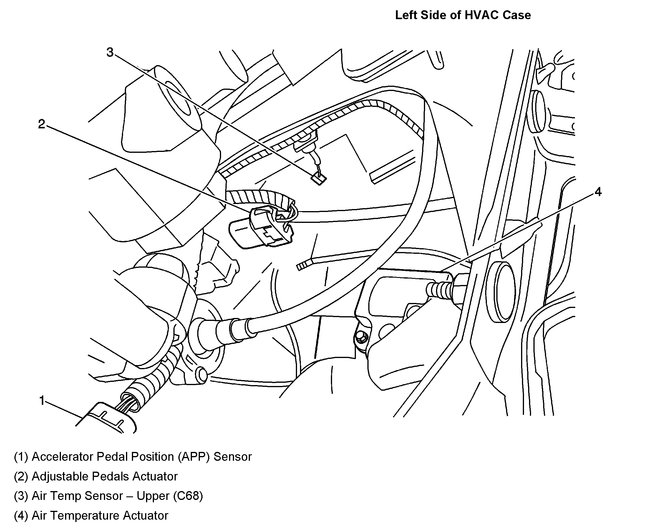

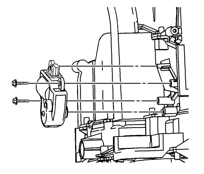

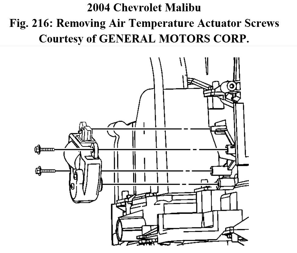

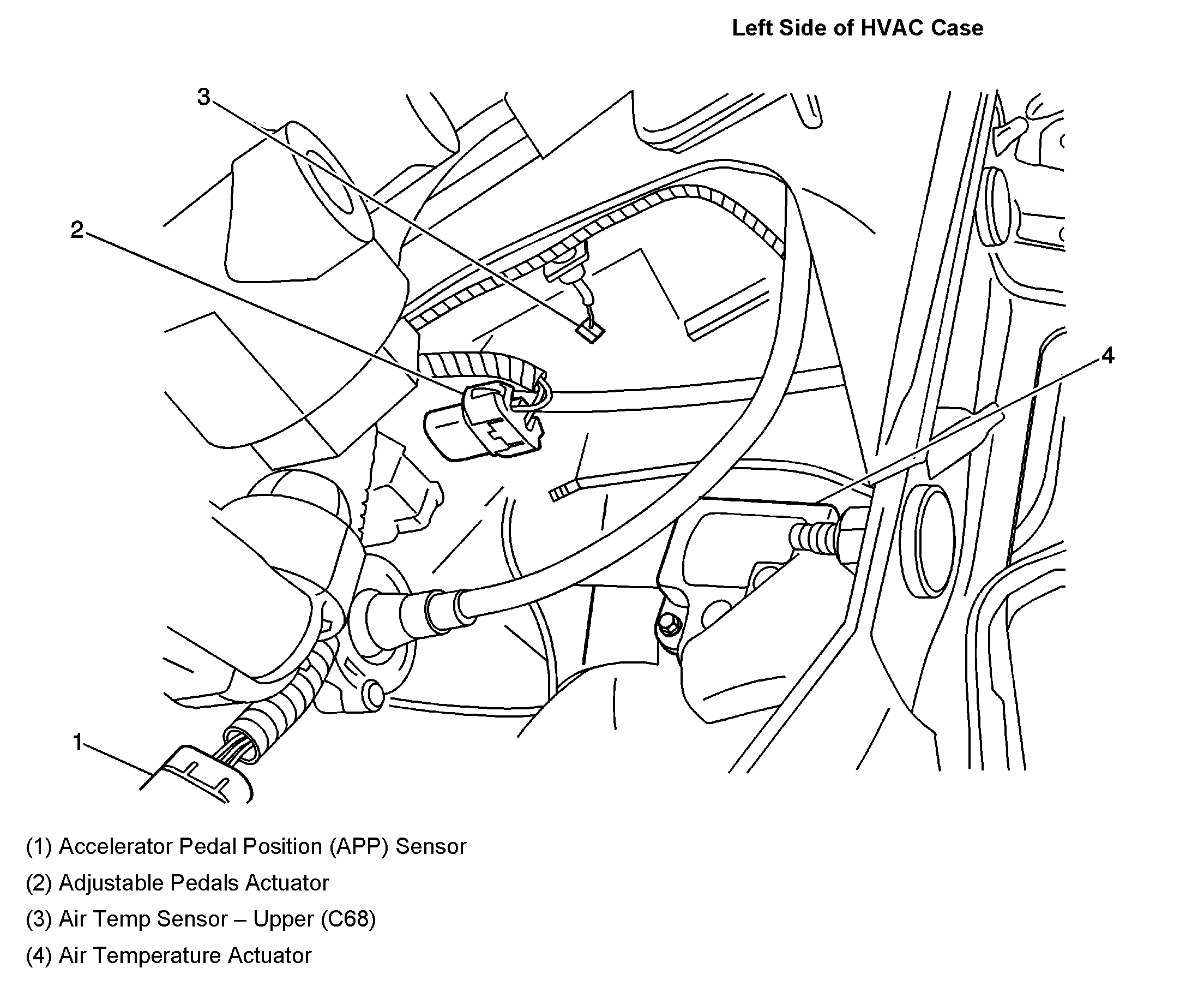

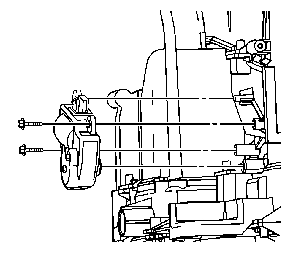

Started out with not very hot heat. Changed the thermostat worked okay, but was told the actuator was going bad by the shop. Had them change it. They also checked the coolant the core and the hoses. On the way home from the shop it worked fine. Turned the heater off when I parked it. The next morning when I got in and and since then I get nothing but cold air no matter how hot I set it. No fogging. No smell no leakage in or out side no overheating the temperature gauge in the car is perfect.
I do not understand why it worked on the way home fine and after turning off the car the next day nothing.
Wednesday, October 28th, 2020 AT 12:53 PM (Merged)
  • 110,192 POSTS
Either the blend air door actuator (which is what I think they replaced) is bad, or it has become disconnected or jammed for some reason. I doubt the heater core has anything to do with this.
If the component has failed, disconnected, or not properly installed, you will not get heat. It is located under the dash on the passenger side of the vehicle. I attached a couple pictures for you to use as a reference. You will need to craw around under there to see if. However, since you just had the work done and it only worked one day, I would take it back.
Let me know if this helps or if you have other questions. Also, once you locate the component, try adjusting the heater in the vehicle and you should feel it working.
