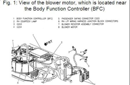

2003 Chevy Malibu 4 cyl Front Wheel Drive Automatic
heater only works on high

Welcome, usually the problem is the resistor assembly. I'd go ahead and check the hvac blower fuse and circuit for voltage, circuit goes hot, when you turn on the key, use a testlite.

How di I change the assembly

https://www.2carpros.com/forum/automotive_pictures/170934_03_malibu_blower_12_1.jpg
Under the passenger side dash, You'll probably have to remove lower part of dash, use your own initiative on the dash. Number 7 in the picture is the connector for the resistor assembly.
