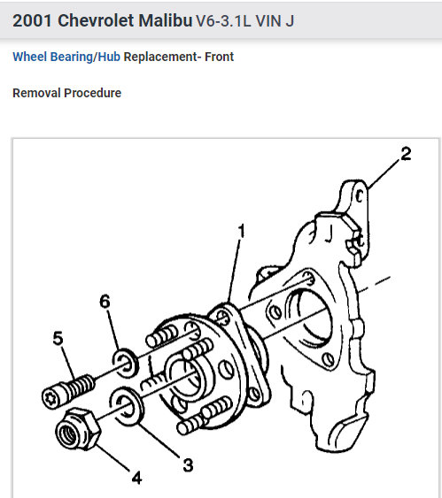

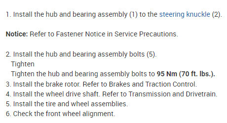

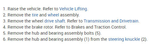

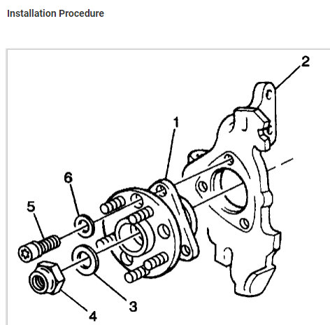

How to check front wheel bearing and possible replacement
Saturday, June 28th, 2008 AT 7:48 AM
DANNY L
MECHANIC
5,648 POSTS
Hello, I'm Danny.
Here is the information you requested. Here is a tutorial showing how to replace a wheel bearing-hub assembly:
https://www.2carpros.com/articles/bearing-hub-replacement
I've attached picture steps below on how to replace the wheel hub assembly for your car. Hope this helps and thanks for using 2CarPros.
