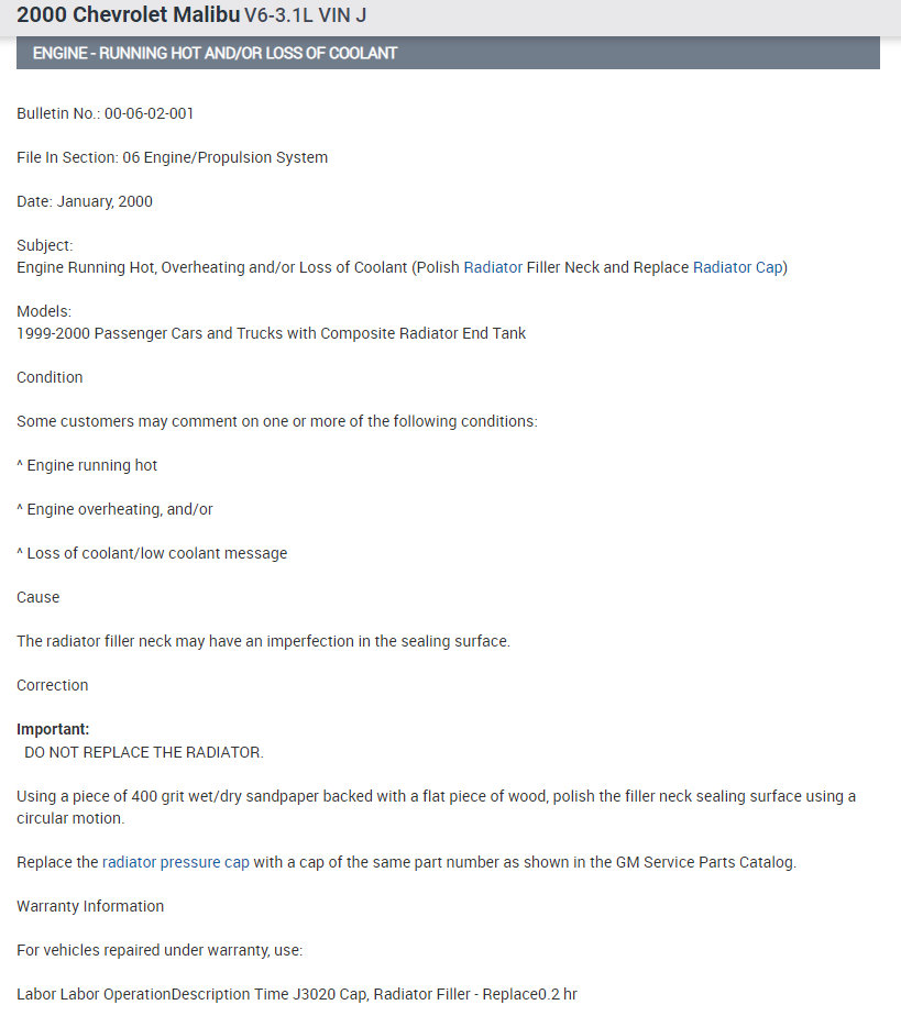

As simple it might sound, but have you changed the radiator cap?
A faulty radiator cap will let coolant escape the system, typically it will drain to the ground. It will only happen when you are driving at the operating temperature. As the pressure inside the cooling system increases with temperature, if the radiator cap is faulty and does not have the required pressure rating, it will let out coolant.
There is an old service bulletin that addresses leaking coolant out of the radiator cap.
You can do a pressure test on the coolant system and see where the leak is coming from.
You will find this video helpful:
https://youtu.be/W8kra65m15c
https://www.2carpros.com/articles/radiator-pressure-test
