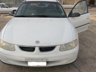

2001 Chevy Lumina engine stops in slow speed
MALE_30003
  • 2001 CHEVROLET LUMINA
  • 6 CYL
  • 2WD
  • 250,000 MILES
http://www.2carpros.com/forum/automotive_pictures/247603_ca5_1.jpg
Thursday, April 9th, 2009 AT 1:52 AM
  • 75,992 POSTS
Stalls like this are often ignition-related and happen when the engine loses spark. The underlying cause is often a bad crankshaft position sensor, or sometimes a failing ignition coil (if the engine has only one coil). A faulty ignition switch that loses contact intermittently may also cause the engine to suddenly die for no reason.
When this happens, open the hood and check for spark. This can be done by pulling off a plug wire (if the engine has plug wires), and placing the end near the block while a helper cranks the engine. DO NOT hold the wire as it may shock you if the ignition system is working. If you do not see a spark or hear the plug wire snapping when the engine is cranking, the fault is in the ignition system.
If the engine has spark, it may have died due to a loss of fuel pressure. When fuel pumps fail, they usually just quit with little or no warning. The engine usually won't restart and the vehicle has to be towed in for repairs. Listen for a buzz from the vicinity of the fuel tank when the ignition is turned on. No buzz means the fuel pump isn't running. It might just be a blown fuse or a bad relay, but on a high mileage vehicle it's often a bad fuel pump.
