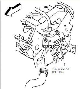

Engine Cooling problem
1999 Chevy Lumina 6 cyl Front Wheel Drive Automatic 200, 00 miles
sorry for spelling. Where does it go. Putting in a new one. The theromostat
Wednesday, November 1st, 2017 AT 8:13 PM (Merged)
JDL
  • 16,098 POSTS
https://www.2carpros.com/forum/automotive_pictures/170934_lumina_thermostat_housing_1.jpg
Welcome, my info showed the above location, 3.1L engine.
