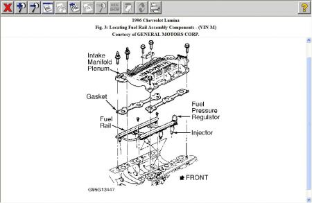

I have a 1996 Chevy Lumina with a 3.1L engine. The problem I have is that the car is misfiring with some hesitation. The code P0305 is coming up on the “Service Engine Soon” light. I have changed the Spark Plugs, Wire Set, Coil for #5 Cylinder, Fuel Filter, and I put cleaner for the Fuel Injector and it is not doing anything, I have been doing that for the past 3 weeks. By the way, every time I go up a little hill or something the “Service Engine Soon” light would flash a couple times. Could you help me with that?

Misfire at no.5 check compression and injector
Misfires can be caused by worn or fouled spark plugs, a weak spark (weak coil, bad spark plug wire), loss of compression, vacuum leaks, anything that causes an unusually lean fuel mixture (lean misfire), an EGR valve that is stuck open, dirty fuel injectors, low fuel pressure, or even bad fuel.

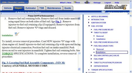

I need to know how to replace a fuel injector on that 1996 Chevy Lumina with a 3.1L engine. If you could help me with that it would be great.
Thank you for all your help rasmataz.
Sunday, September 28th, 2008 AT 5:29 PM
  • 75,992 POSTS
See below sir-follow it accordingly
https://www.2carpros.com/forum/automotive_pictures/12900_intake_1.jpg
https://www.2carpros.com/forum/automotive_pictures/12900_inj2_1.jpg
https://www.2carpros.com/forum/automotive_pictures/12900_intake_2.jpg
Good Luck and TY for using 2carpros
