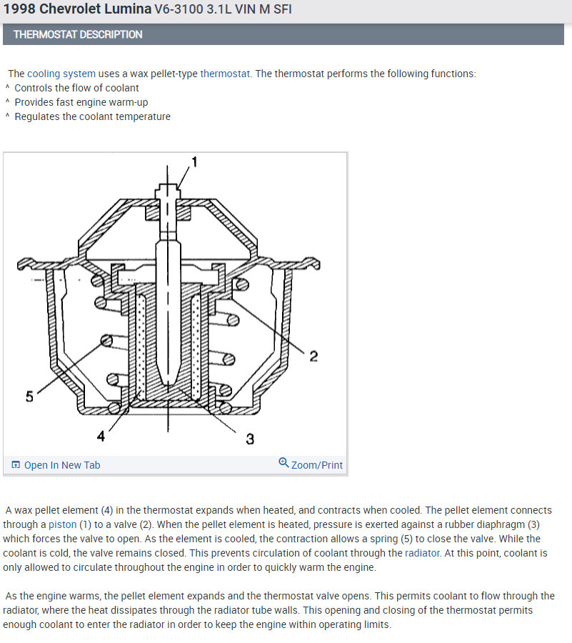

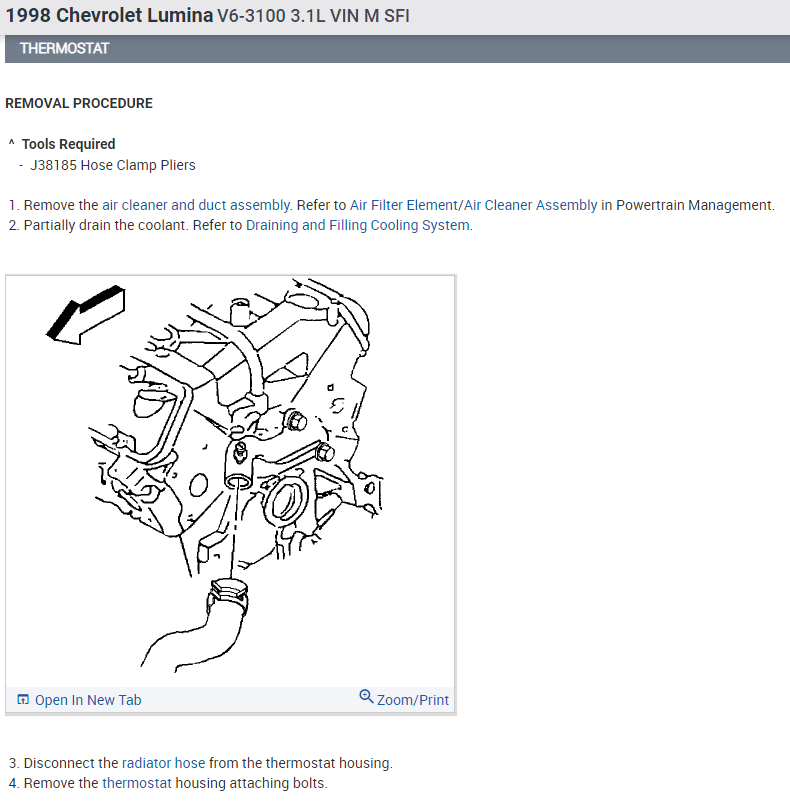

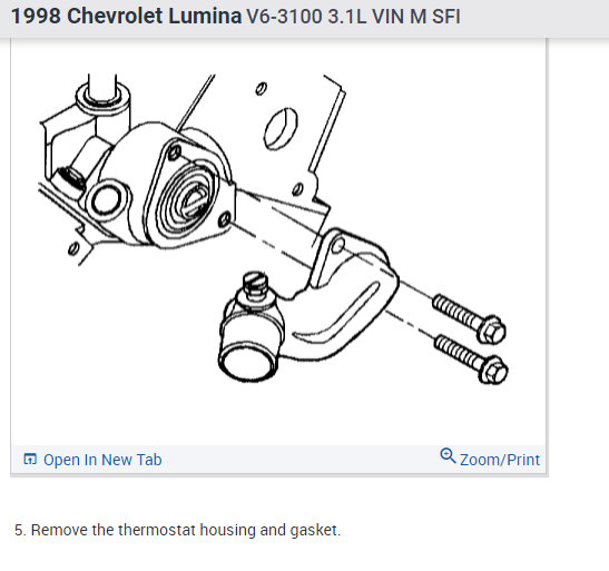

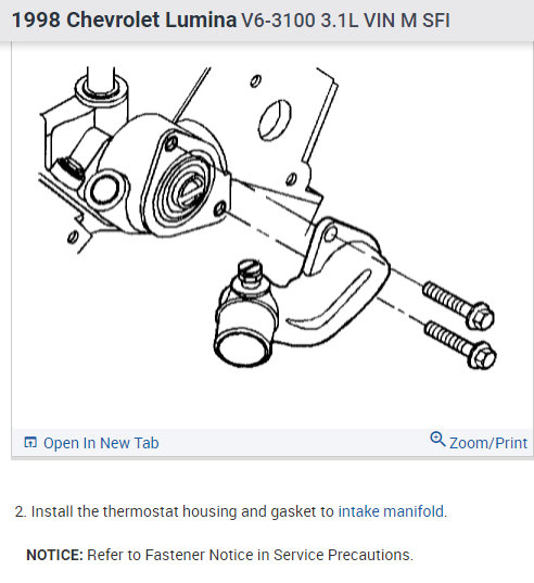

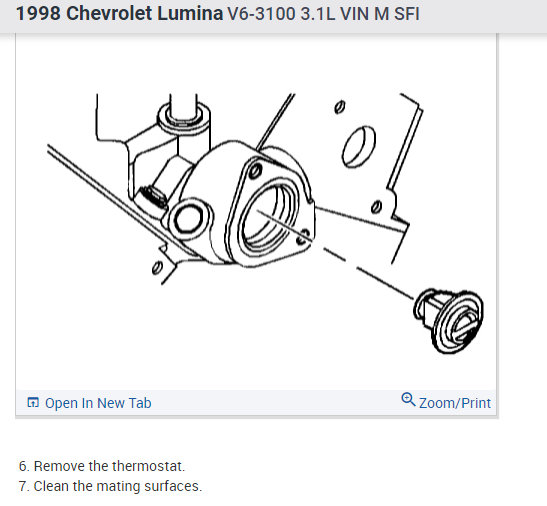

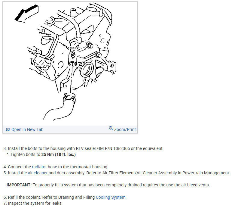

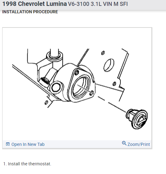

The issue you are describing sounds like a stuck closed thermostat. When a thermostat fails at closed position, it will prevent coolant from flowing thru the engine. This will crate a temperature difference between the two radiator hoses, one will be hot and another relatively cool.
https://www.2carpros.com/articles/how-an-engine-thermostat-works

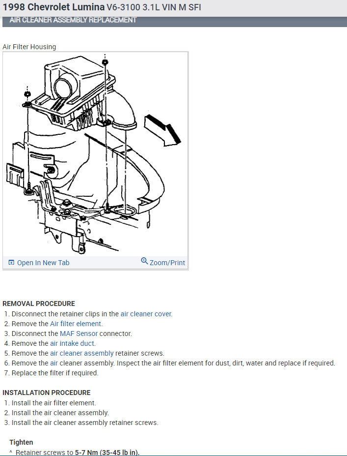

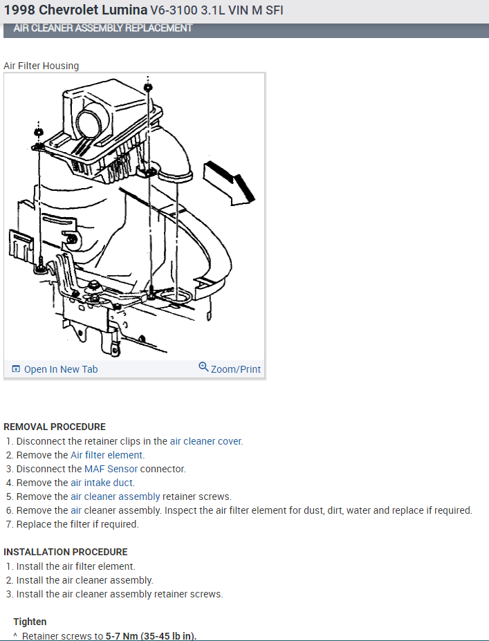

I have attached the thermostat replacement diagrams for your reference.
