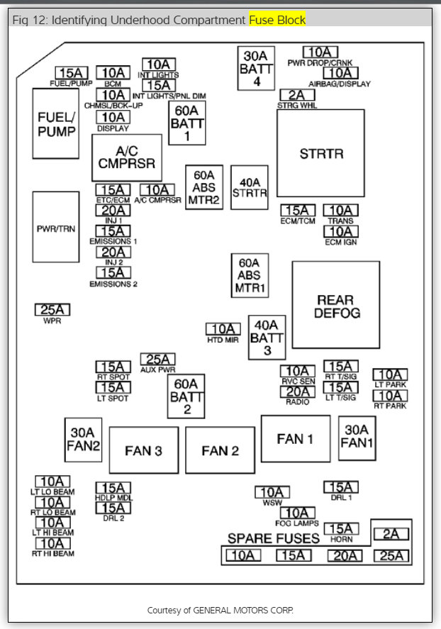

I get a display on the dash that says"engine power reduced."
The only codes that come up are P0106, P0449, P0452.
There are no other codes!
These three codes do not say anything about "engine power reduced."
Please help.
Saturday, September 19th, 2020 AT 2:28 PM
(Merged)
KEN L
MASTER CERTIFIED MECHANIC
55,424 POSTS
Anytime you have code the engine power will be reduced. You have a BARO and EVAP codes is there any symptoms along with the codes?

The engine is a little hard to start. It cranks a little longer than usual but, when I give it a little more gas, the car runs fine. New fuel pump and fuel filter (under frame).
Traction also shows up on dash. Could the inhibitor relay be defective?
Thank you very much for your reply.

Here is my take on this whole thing. The p0106 is for your map sensor the p0449 is for the vent control solenoid circuit and the p0452 is for your fuel tank pressure sensor. What do all three have in common they all share the same five volt reference signal or five volt power supply to them. I would be checking the fuses under the hood see if any are blown. Also, those codes will not or should not put the car in reduced performance mode. That happens when there is a fault in the throttle by wire system like a fault in the throttle position sensor gas pedal sensor etc. The traction light might be a clue if it is seeing wheel slippage or thinks that is happening then it would retard the timing and cause a reduced performance feel etc. That would take more than a basic diyer code reader to read ABS or traction control codes. I would first looking into those three codes your getting and see where that takes you. Let me know what you find with the fuses if any are blown.
+2

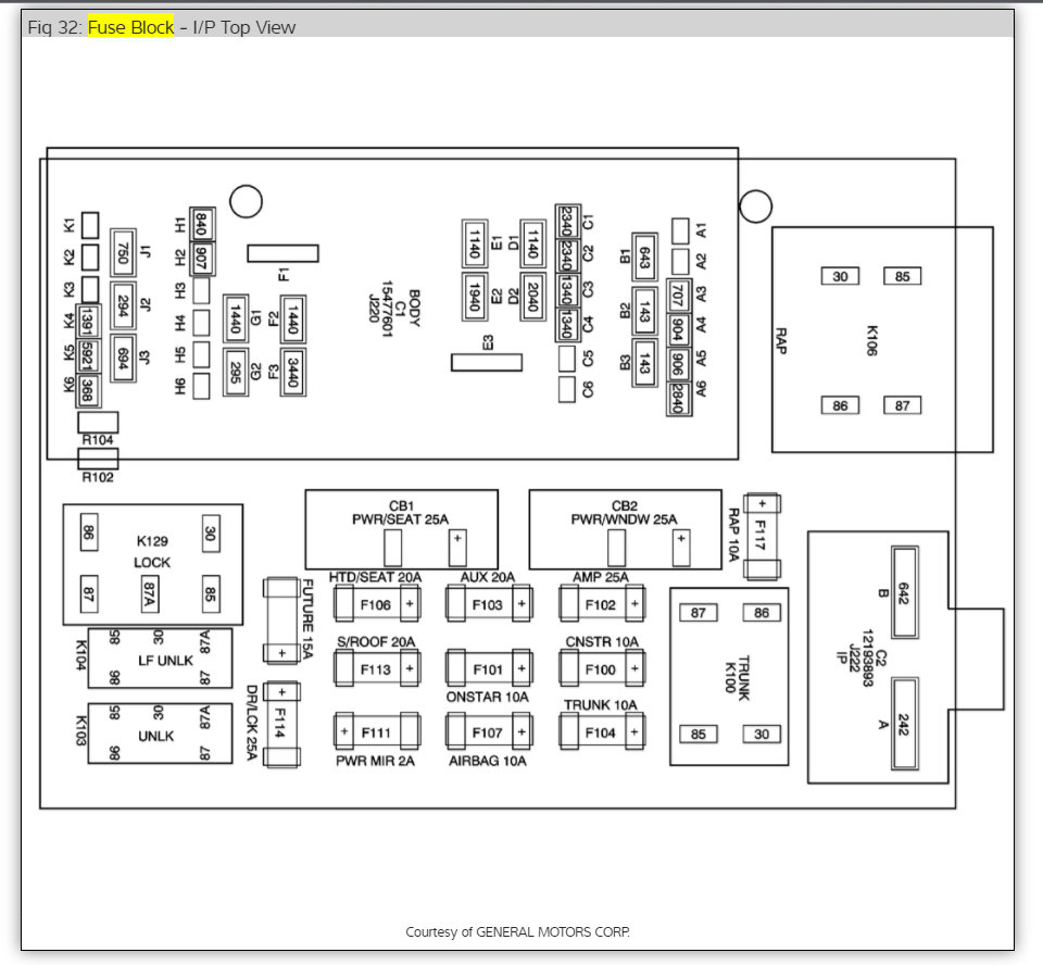

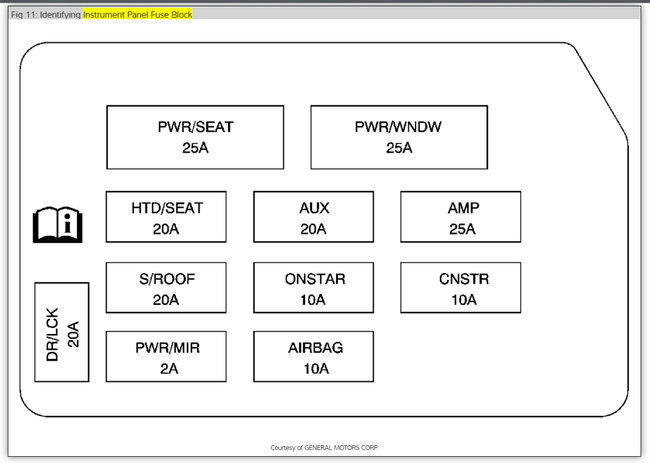

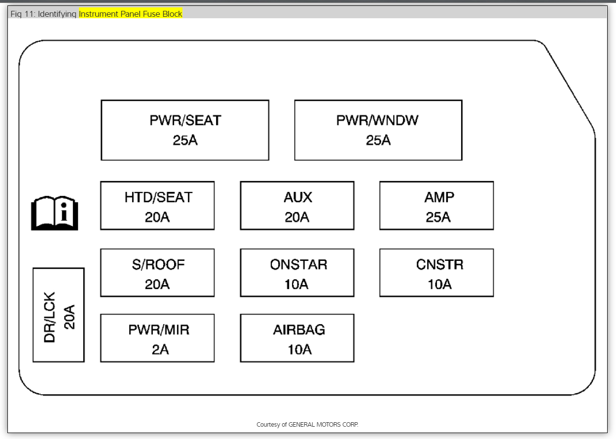

Nice catch Saturntech9.
Here is a guides and some diagrams (Below) of the fuse layout:
Please let us know what you find. I am interested to see what it is.

I would be really looking in the under-hood fuse box at the 15 amp emissions 1 and emissions 2 fuses.
