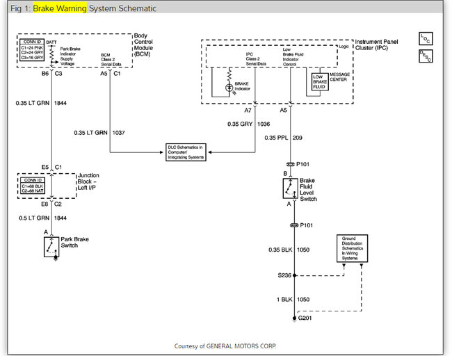

The brake light went off on the front panel with the message brake fluid low and on the left side brake light message went off too, I cheked fluid level is ok, brake pads are ok, and I purged the four wheel so what is the problem with my car?
Friday, April 23rd, 2010 AT 4:30 PM
13 Replies
F4I_GUY
  • 3,302 POSTS
If the fluid is topped up, the problem is with the brake fluid level sensor located in the reservoir. If that doesn't work, you may need to have the ABS system scanned for codes. Even though it is not the ABS light, it can be related to an ABS issue
Read the guide below, it will explain.
https://www.2carpros.com/articles/brake-system-warning-light-on

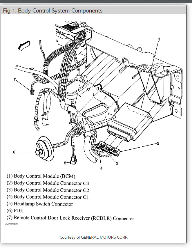

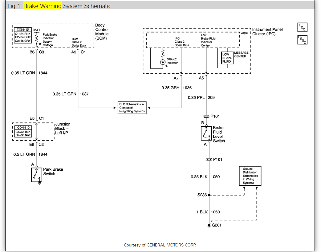

Had the LOW BRAKE FLUID message come up in the message center. TRAC OFF light and BRAKE light also came on. Never lost brake function. The fluid was not low in the reservoir tank. Had the sensor replaced to see if that corrected the issue and it did not. Car is functioning well otherwise. There are no leaks in the lines or calipers. The fluid level has not changed. Brake pads are not low either. Have read info that it could be a BCM or ignition switch. LIghts have remained on. Have also tried disconnecting the batt cables for a few minutes and that did not reset anything. Any ideas? Thanks!
Saturday, November 24th, 2018 AT 8:15 AM (Merged)
I would check the connection between the sensor and the BCM if okay the BCM is bad here is a guide to help test the wire and the wiring diagrams so you can see the color wire and the BCM location in case you need to replace it with a rebuilt unit.
Check out the diagrams (Below). Please let us know what you find. We are interested to see what it is.
Cheers, Roy
ML44
The reservoir was never low on fluid. Plus, the ABS light never came on. Only the red park brake light, TRAC OFF and LOW BRAKE FLUID in the message center. The fluid level remains at the max line. I checked the wire it was okay had the BCM replaced, cost me $350.00

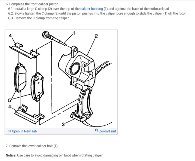

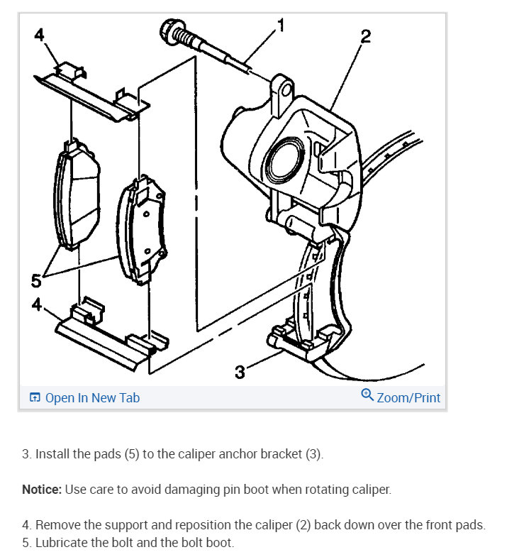

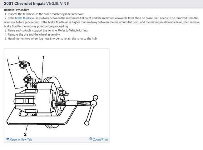

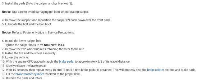

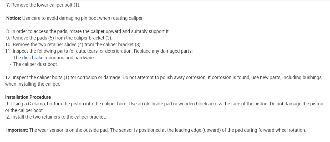

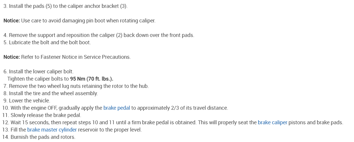

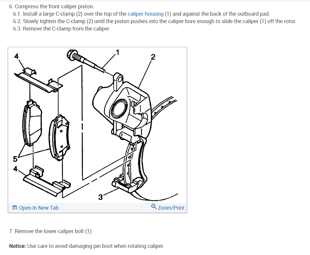

My 2001 chevy impala was running fine and still its just that recently the brake warning light in the dash came on, I tried checking brake fluid, brakes, brake switch, brake pads, even parking brake, everything looks good expect the brake light in the dash, is there anything that I am not looking at. Please help me or guide me what to look for
thank you
Saturday, April 25th, 2020 AT 11:58 AM (Merged)
It sounds like the brake fluid is low due to the car needing front brake pads which is what I would check first. Here is a guide to help you see what you are in for when doing the job step by step and instructions to do the job on your car in the diagrams below.
Video - https://youtu.be/9v9Xsx5Wjf8
+1
SHAHZADA
You were right the car needed brakes my son did them after checking out the guide you sent all fixed! Thanks for your help.
+6
