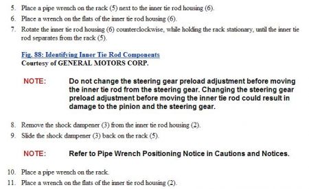

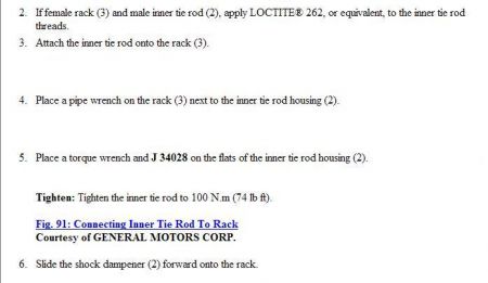

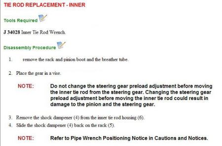

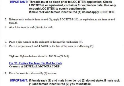

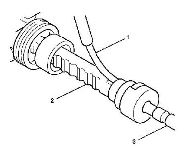

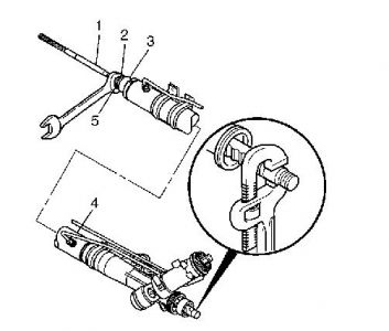

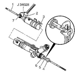

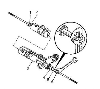

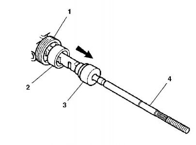

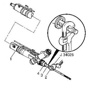

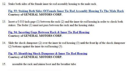

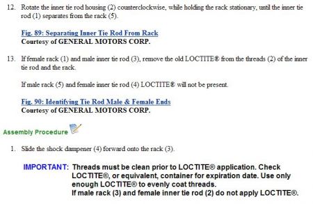

Okay, sorry about that. Below are the inner tie rod removal instructions. If you still have problems just let me know..
https://www.2carpros.com/forum/automotive_pictures/261618_Noname_223.jpg
https://www.2carpros.com/forum/automotive_pictures/261618_Noname2_68.jpg
https://www.2carpros.com/forum/automotive_pictures/261618_Noname3_40.jpg
https://www.2carpros.com/forum/automotive_pictures/261618_Noname4_24.jpg
https://www.2carpros.com/forum/automotive_pictures/261618_Noname5_12.jpg
https://www.2carpros.com/forum/automotive_pictures/261618_Noname6_7.jpg
FIGURE 88
https://www.2carpros.com/forum/automotive_pictures/261618_88_1.jpg
FIGURE 89
https://www.2carpros.com/forum/automotive_pictures/261618_89_1.jpg
FIGURE 90
https://www.2carpros.com/forum/automotive_pictures/261618_90_1.jpg
FIGURE 91
https://www.2carpros.com/forum/automotive_pictures/261618_91_1.jpg
FIGURE 92
https://www.2carpros.com/forum/automotive_pictures/261618_92_1.jpg
FIGURE 93
https://www.2carpros.com/forum/automotive_pictures/261618_93_1.jpg
FIGURE 94
https://www.2carpros.com/forum/automotive_pictures/261618_94_1.jpg
FIGURE 95
https://www.2carpros.com/forum/automotive_pictures/261618_95_1.jpg

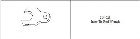

SPECIAL TOOLS
https://www.2carpros.com/forum/automotive_pictures/261618_t_1.jpg

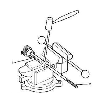

This is my first inner tie rod replacement and am not too familar with staking are there staking tools to make this job easier or any tips?
And again thanks for the info you couldnt have been more clearer.
+1
Sunday, February 8th, 2009 AT 2:18 AM
BLUELIGHTNIN6
  • 16,542 POSTS
Need a hammer and punch. Make sure to use a wooden block to support the opposite side of the rack and inner tie-rod end while staking. (pictured below)
https://www.2carpros.com/forum/automotive_pictures/261618_Noname_225.jpg

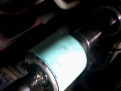

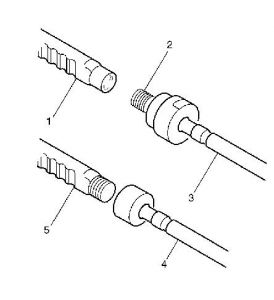

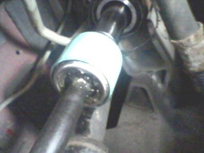

Here is a picture of the inner tie rod housing. In thew instructions you gave me the wrench will work on the new housing that i have but will not on the stock housing. Look at this picture and get back to me on what tool i use on the stock inner tie rod housing:
https://www.2carpros.com/forum/automotive_pictures/311287_inner_housing_tie_rod_green_1.jpg
https://www.2carpros.com/forum/automotive_pictures/311287_inner_housing_tie_rod_green1_1.jpg
Saturday, February 14th, 2009 AT 4:32 PM
BLUELIGHTNIN6
  • 16,542 POSTS
Once the lock nut is backed off and the tie rod is disconnected from the steering arm, hook the ring spanner over the threaded end. Then turn it off.
Saturday, February 14th, 2009 AT 6:04 PM
ANNF14
Hello all you have to do is remove that outer coating (plastic) and the tool just slide right in if you have the apropriate size.

First check to see if the rods are equipped with holes to do the staking in the first place. If it does, then just support the rack while you're staking.
