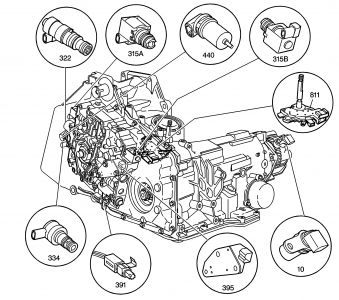

Where can I locate the Speedometer Sensor for this vehicle?

It is on the extension housing of the transmission,near the right side cv axle.
(10) Vehicle Speed Sensor (VSS) Assembly
(315a) 1-2, 3-4 Shift Solenoid (SS) Valve Assembly
(315b) 2-3 Shift Solenoid (SS) Valve Assembly
(322) Pressure Control (PC) Solenoid Valve Assembly
(334) Torque Converter Clutch Pulse Width Modulation (TCC PWM) Solenoid Valve Assembly
(391) Transmission Fluid Temperature (TFT) Sensor
(395) Transmission Fluid Pressure (TFP) Manual Valve Position Switch Assembly
(440) Automatic Transmission Input Shaft Speed (A/T ISS) Sensor Assembly
(811) Lever Assembly-Manual Shaft Detent with Shift Position Switch - Internal Mode Switch (IMS)
