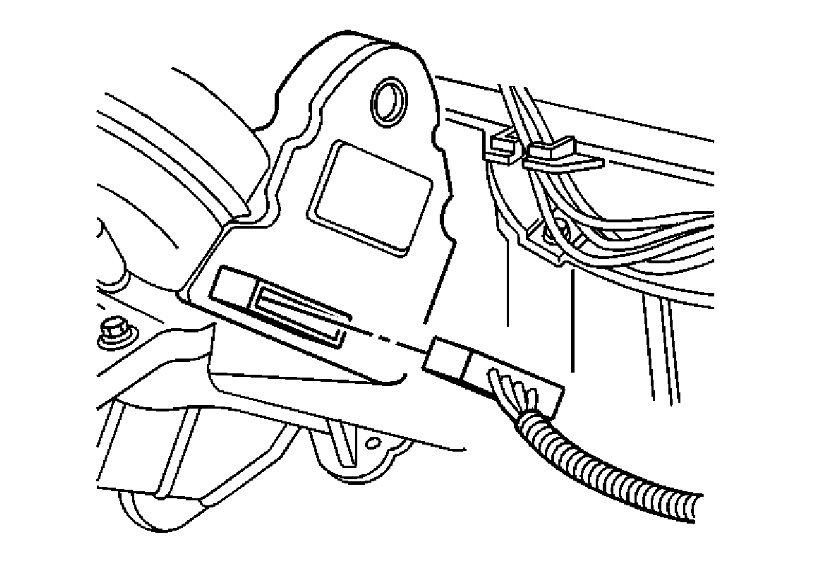

SONNYSCH123
Where is "blend doors" in the heater control module?
Monday, January 13th, 2020 AT 6:52 PM (Merged)
Good evening.
Procedure below and picture attached. You can get these at any parts store.
REMOVAL PROCEDURE
1. Remove the right side instrument panel (IP) insulator.
2. Remove the IP compartment.
ImageZoom/Print
3. Disconnect the electrical connector from the right air temperature actuator.
ImageZoom/Print
4. Remove the screws retaining the right air temperature actuator.
5. Remove the right air temperature actuator.
