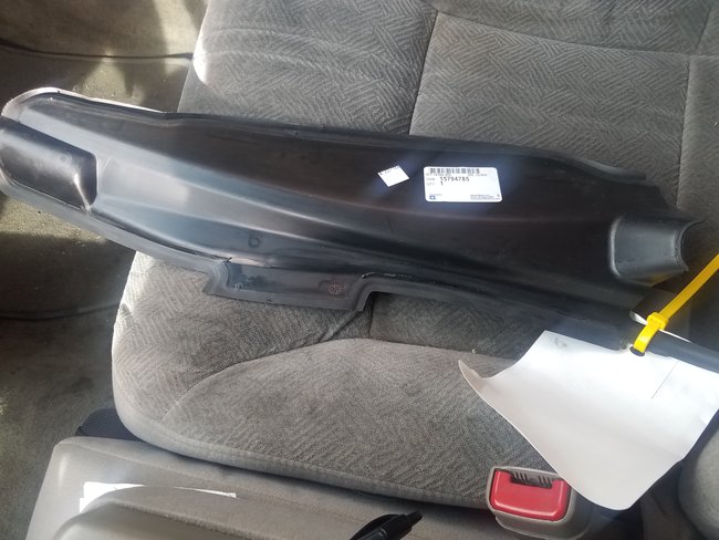

Part number 1579-4785 should fix the problem. It covers the cabin air filter which is located on the passenger side underneath the plastic shroud.
