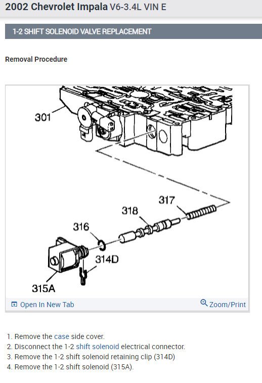

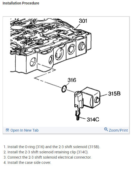

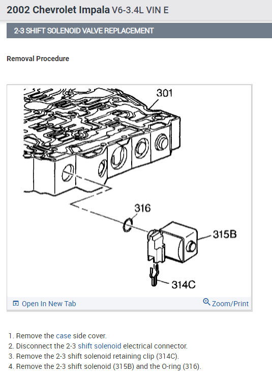

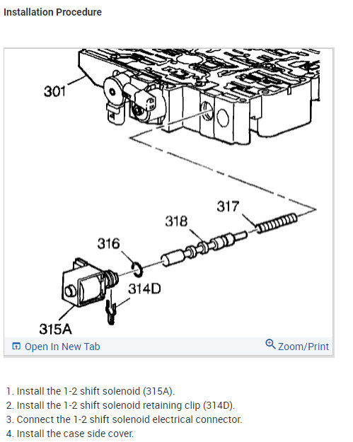

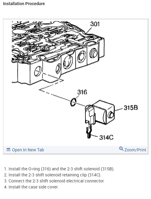

You can access the shift solenoid by removing the side cover of the transmission.
This vehicle has 2 shift solenoids.
One for 1-2 and the other 2-3.
Since it is relatively easy to replace the solenoids, it is probably a good idea to change them out to see if it fixed the issue, before rebuilding the transmission.
