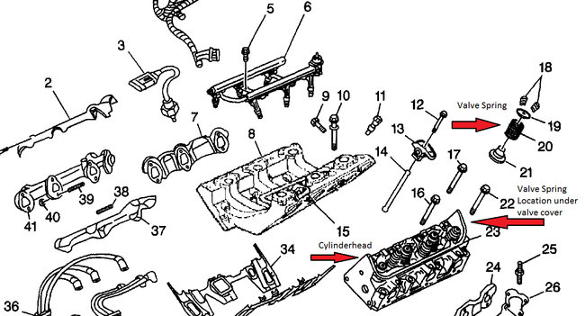

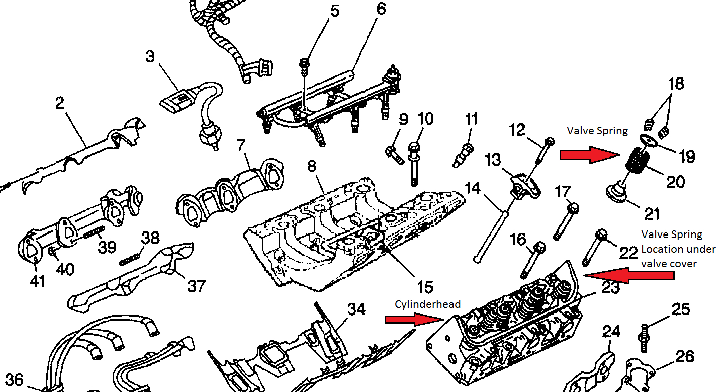

The valve spring, if it really needs one, can be replaced with out taking the whole engine apart, I own a 2001 impala. Its a duel overhead cam set up, the springs, rocker arms, and lifters are all right under the valve covers. Do you know what size engine is in it? It should be marked on a label under the bottom of the hood. Ill find a diagram to show you what it looks like.

Heres a breakdown of the upper part of the engine, a technician that knows what hes doing can replace the Valve spring without having to take too much apart. But a compression test needs to be done first to determine if that's actually the problem.
