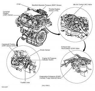

KITESMITH
My 2002 Impala 3.4 V6 (125,000 miles) has been doing the same thing for some time, intermittently. Sometimes if I turn off the engine, like at a stop light, and restart it, the idle returns to normal.
It may be the idle air control valve (IAC). My Haynes manual troubleshooting section says that may be a cause. Yesterday, I removed it, cleaned it, and cleaned the inside of the opening in the housing where it is installed. Both had a lot of carbon buildup. That did not help. My next step will be to replace it.
It is easy to get to, and you only need to move a few things, and have the right torx screwdriver to get it out and back in. Best of luck!

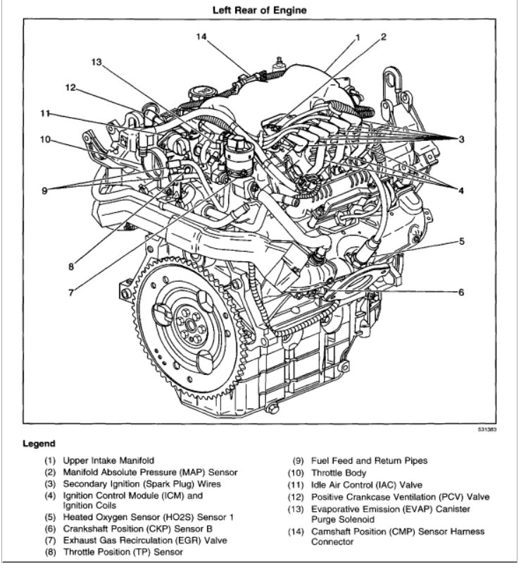

RAY_STEIN
Car:
2002 Chevrolet Impala, 3.4L engine, Automatic.
Symptoms:
Intermittent high idle upon start.
Intermittent high idle while driving (as if the cruise control is activated).
Intermittent high idle (audible) when at stop after driving (even if the car idled fine upon start).
Findings at Shop:
None.
No diagnostic codes.
High idle blamed on IAC (idle control motor).
(It appears that when the car idle fine nothing is even sending questionable data to the PCM).
(It appears that when the car is idling high, nothing points to a specific sensor/control)
What I did:
Shotgun sensors until I found a something that seems to fix the problem.
Sensors replaced:
IAC (intake air control valve, replaced at shop for $250.00 (parts and labor).
IAT (intake air temp sensor, purchased for parts store for $15.00).
TPS (throttle position sensor, purchased at stor for $40.00).
What finally worked for me was the replacement of the TPS.
The car now seems to be working fine (hopefully it continues to do so).
It could have been linked to all three for all I know.
I did replace them in steps (first the IAC, then the IAT, then the TPS).
The only thing that proved to make a difference was the new TPS.
My suggestion to anyone that has this problem.
Replace these three items, they are cheap when purchased at a parts store (not from the dealer).
They are all in the same area on the motor/intake.
All the parts should cost you less than $150.00.
You need some tools (torx drivers, extensions, socket wrench, etc).
For a novice, within one to two hours you should be done.
Hope it works for you.
I suffered with the problem for two years. I am so glad that it finally appears to be over!

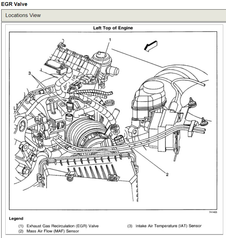

Aug 1, 2016 at 11:45 AM
  • CAR REPAIR CONTRIBUTOR
  • 54,334 POSTS
I have seen the EGR hang open causing the engine to idle high as well. Here is the location and a video to show you how to test it:
https://youtu.be/DqUCbbKdWf4
and
https://www.2carpros.com/articles/engine-idles-too-high

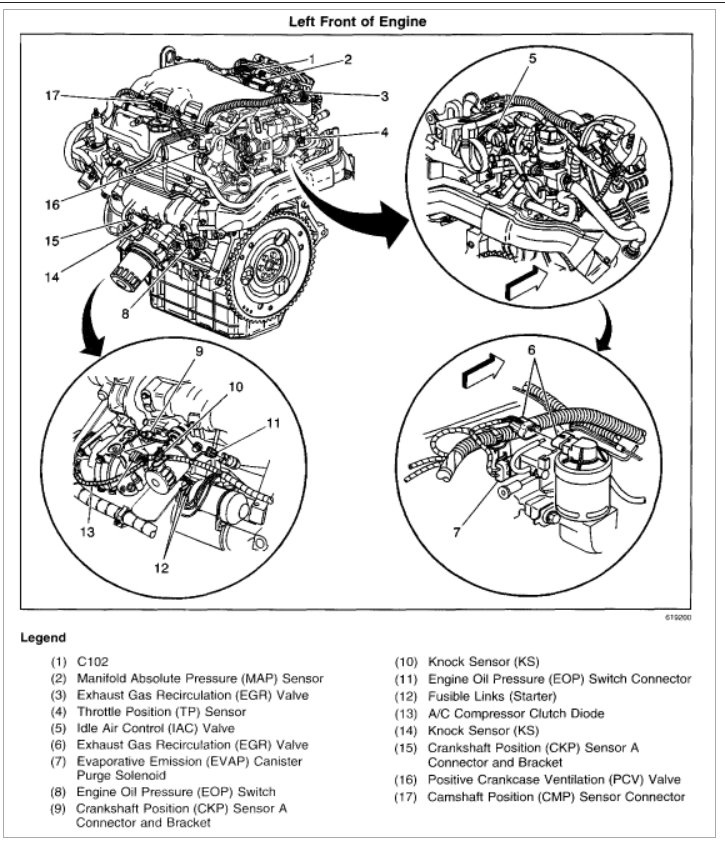

ROLLINROB
I have a 2001 Chevy Impala with a 3.4L. When I start the car, it will idle fine however when I go to take off with it, it wants to pick up speed and idle high (will go as fast as 45MPH without touching the gas!). When in park after it wants to go its own speed/rpm, it will still idle high. I have changed the plugs, wires, coil packs, the sensor under the packs, throt. positioning sensor, fuel filter (fuel pressure is perfect), o2 sensors... what else can it be? I am trying to advoid the dealer, as I can not afford to pay them and they won't help me a bit! Thanks for your help!
Oct 29, 2019 at 6:32 PM (Merged)
2CARPRO JACK
  • 11,533 POSTS
Could be a sticky Idle Speed Control motor. Try cleaning it with carb cleaner first, might help, might not . That is one of th efew things that can make the engine rpm on its own
ROLLINROB
Where would I locate the part? Thank you very much for the advice!
2CARPRO JACK
  • 11,533 POSTS
This is the best pic I can find of where it is at.It is located on the throttle body.
https://images.2carpros.com/forum/automotive_pictures/1639_IAC_1.jpg
ROLLINROB
Car has been fixed... It was a defective Idle speed control motor. Replaced it with a new one from Auto Zone for $52.99 and problem solved! I appreciate your help you have provided us!
