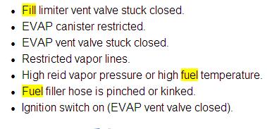

Every time I get gas the fuel pump clicks as if it is full about every 6 or so cents of gas. I know that the tank is low, but it reacts as if it is full. Getting gas is a pain. Gas is now starting to spit back out of the spout while fueling

https://www.2carpros.com/forum/automotive_pictures/170934_Impala_hard_to_fill_1.jpg
Where applicable, check the above. Any codes? All gas pumps are not created equal, some give me problems, others don't.
