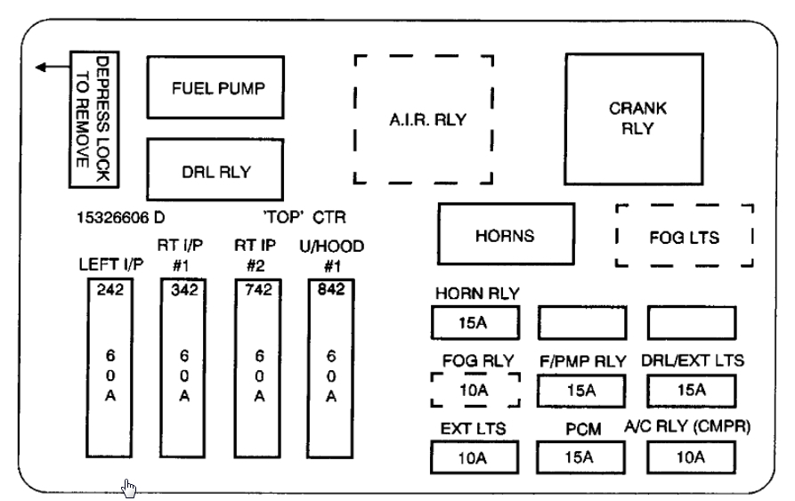

Does my car have the relay for the fuel pump? If so where is it located?
Wednesday, July 23rd, 2008 AT 9:41 PM
MECHANIC
18,907 POSTS

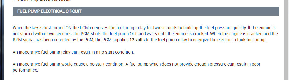

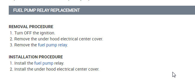

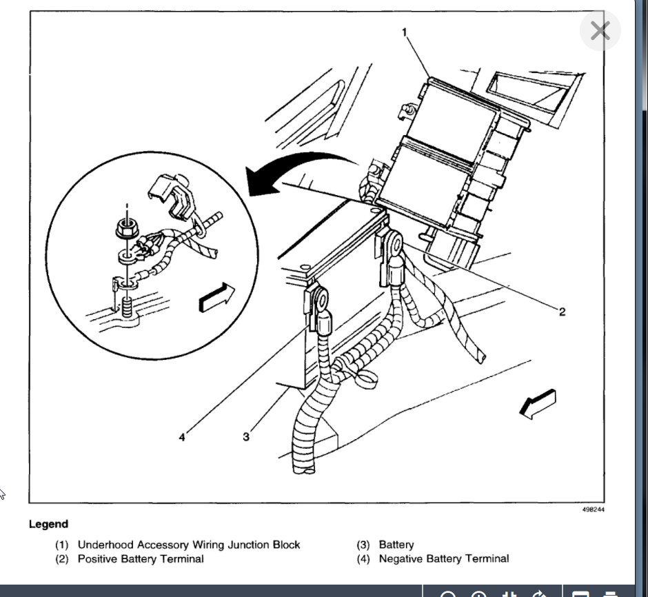

Yes you do. It is in the underhood fuse block. Here is a guide that will help with this:
Below is the info from the manual. Please let us know if you have of questions. Thanks
