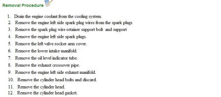

Hey there just wondering if there would b a way to get step by step guide on how to repair Head Gastkets.
thanks

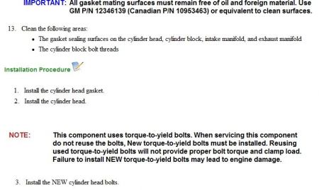

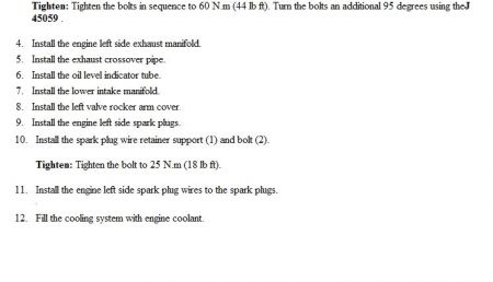

Steps are below for the left side gasket, right side is similar
