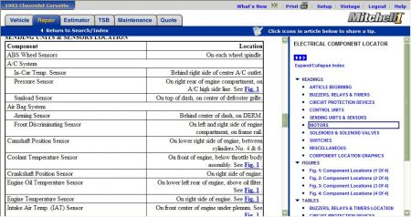

I have a 1993 Corvette.69000 miles. I wash thge car and carefully washed the engine. The car started fine when I finished, however, died after idling about 1 minute. Now, it will not start. Thinkingsomething may have gotten wet, I waited until the next morning to try again. Same. Engine turns over but will not start. What should I check?

For a start inspect/test the camshaft position sensor at lower right side of engine between 4 an 6 cyl. and crankshaft positioning sensor at also right side of engine.
https://www.2carpros.com/forum/automotive_pictures/12900_Crankshaft_and_Camshaft_93_Corvette_1.jpg
