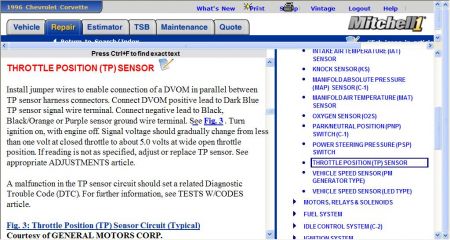

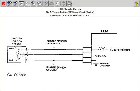

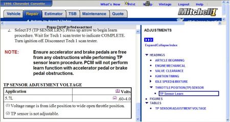

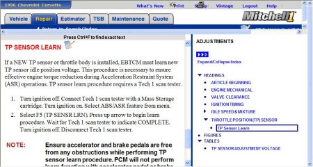

When adj. The idle and IAC count, how do you Adj. Or reset the TPS?
Thanks
Friday, August 15th, 2008 AT 11:36 AM
MECHANIC
75,992 POSTS
See below
