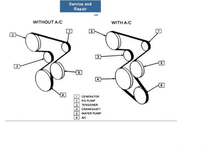

How do you change a belt on a 4 cly. THANKS

1. Disconnect battery ground cable, then remove coolant recovery tank.
2. sing 19 mm wrench, pivot tensioner and remove belt from alternator.
3. Raise and support vehicle, then remove inner fender splash shield.
3. Remove A/C belt, if equipped.
4. Remove serpentine drive belt.
5. Reverse procedure to install.
https://www.2carpros.com/forum/automotive_pictures/248015_belt_1.jpg
