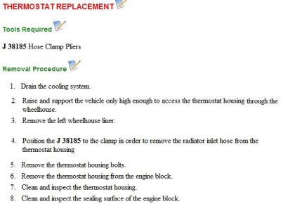

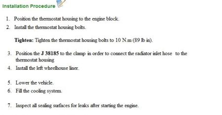

I am trying to install a new thermostat in my Chevy. But since it is newer the dam thing is pretty hard to get to. I was wondering what way would be the easiest to get the new one in there
Monday, March 29th, 2010 AT 7:21 PM
BLUELIGHTNIN6
  • 16,542 POSTS
Hello and thanks for donating!
Below are the proper replacement steps for your vehicle's thermostat...
