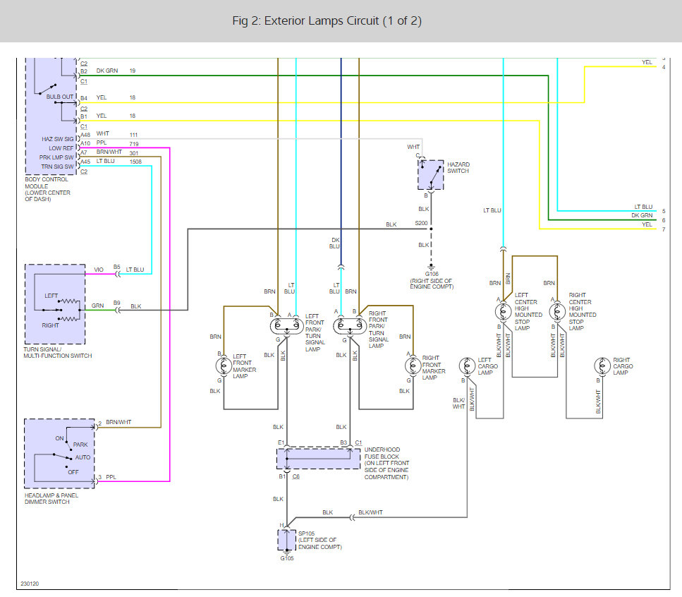

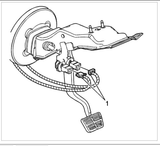

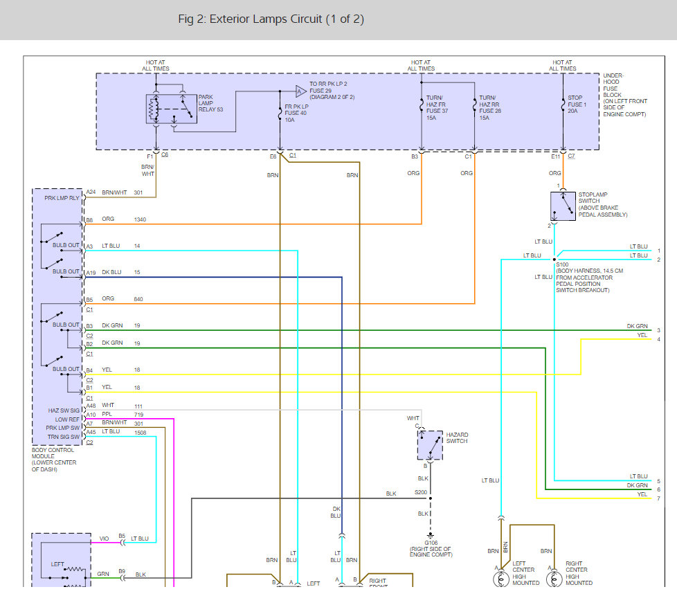

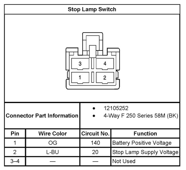

It sounds like you have a brake light switch that is not triggering the BCM. Here is a guide and some wiring diagrams (below) to help you confirm the failure.
Here is a guide to help you test trough the switch

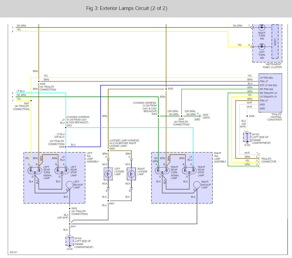

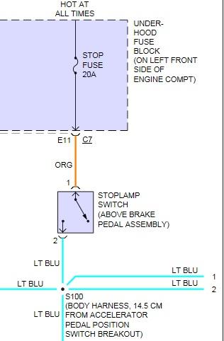

JDL
  • 16,098 POSTS
Just wanted to add the diagram. The orange wire carries voltage to brake switch. When brake switch is activated, the lite blue wire carries voltage for brake lamps. Did you check brake fuse?

RUSS0196
  • 5 POSTS
Wow thanks for the fast reply. I have checked voltage from both orange and blue wires and everything checks out the circuit opens and closes.I even checked voltage at my trailer hook up in the back and it gets 12 bolt while pressing on the brake and 0 when depressed.

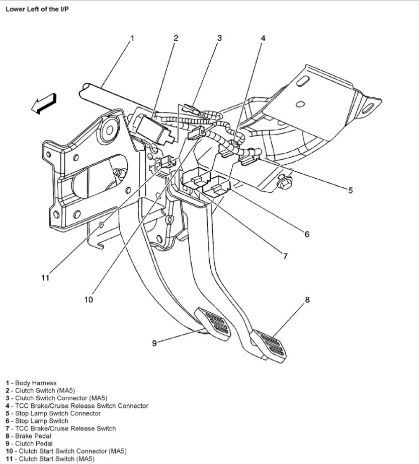

  • 110,194 POSTS
At the top of the brake pedal is the brake light switch. Make sure it is adjusted and is getting power both in and out.

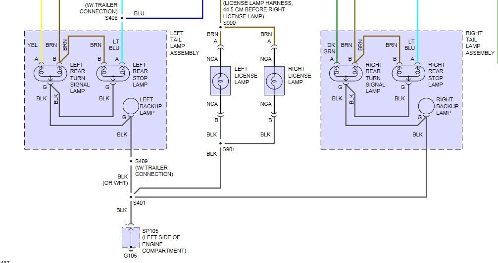

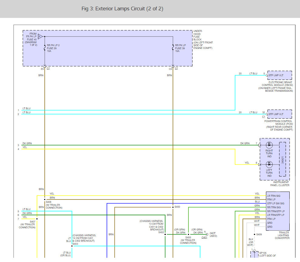

JDL
  • 16,098 POSTS
At the rear tail-lamp assembly, did you check for voltage at the light blue wire with brake switch activated? Anything there? Also, the black wire is ground, check that, also. Note some of your other rear lamps use the same ground as the brake lite.

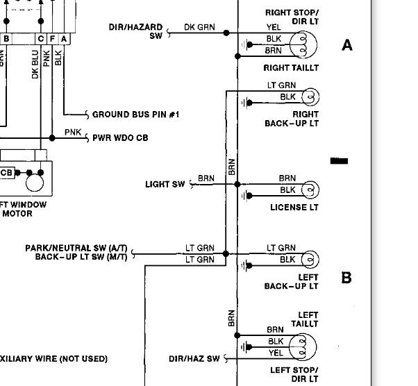

JDL
  • 16,098 POSTS
Sorry, that last diagram was wrong. I grabbed the wrong one.
Friday, October 13th, 2017 AT 3:20 PM (Merged)
JDL
  • 16,098 POSTS
I'll try it, again.

RUSS0196
  • 5 POSTS
Ok. I have just tested the blue wire at the tail light. I dont know if this means anything bit im getting.08 volts when peddle is pressed and zero when depressed. Thought! Could the voltage be getting drawn elswhere? I tested the connections under the truck where the wires split off to each light assembly and I get 12 volts at the connector to the T and 12 volts after.
