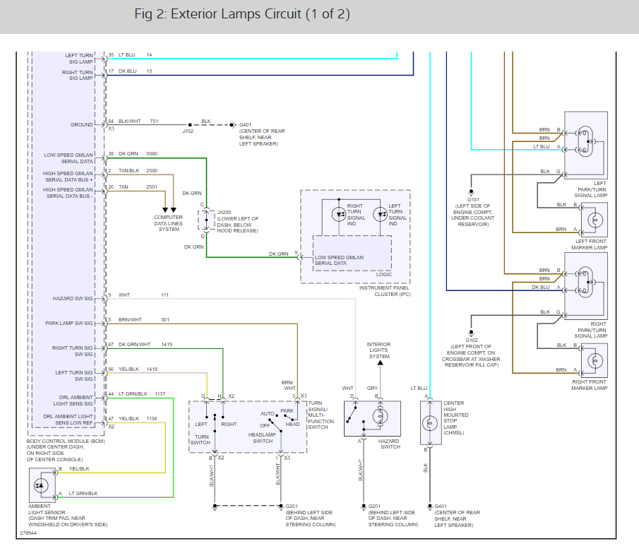

Recently the seat belt, lights on and key in the ignition when off and door open stopped working. Also turn signals and 4 way flashers work but there is no clicking. What has caused this and where can I locate the flasher?

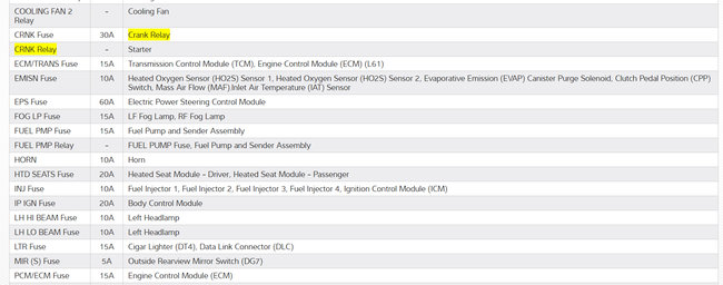

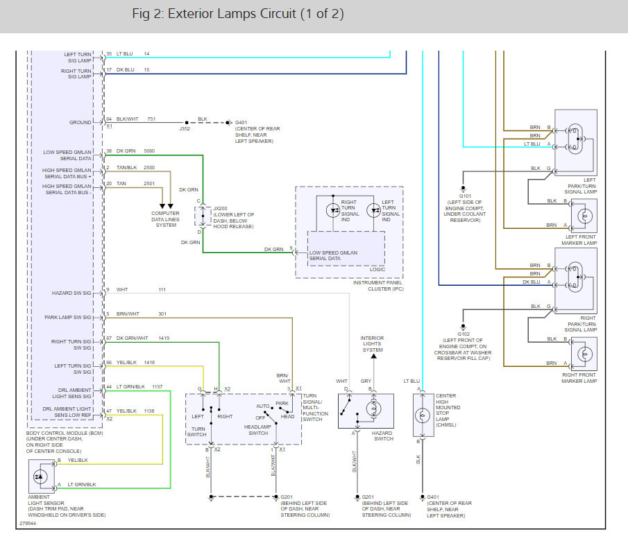

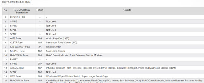

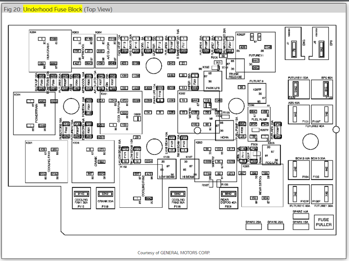

MMPRINCE4000
  • 8,548 POSTS

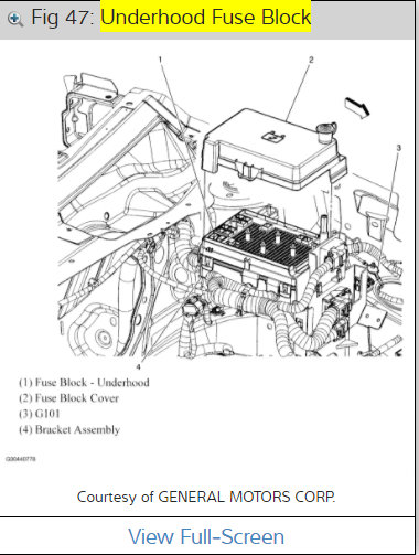

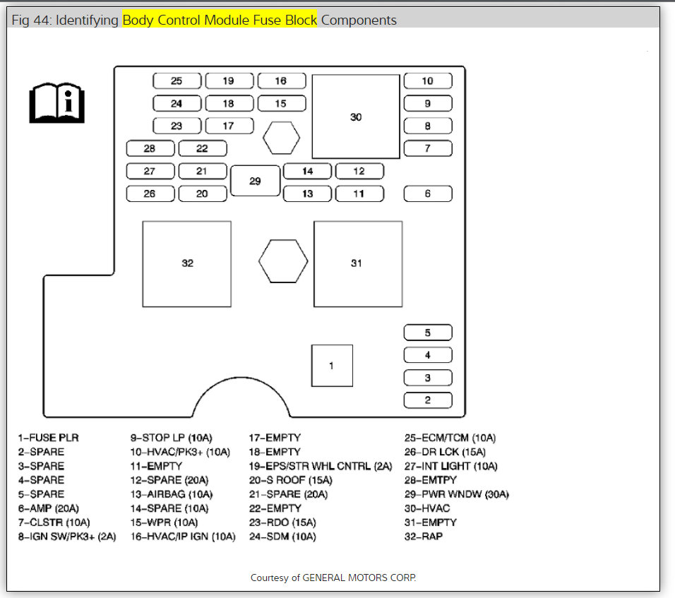

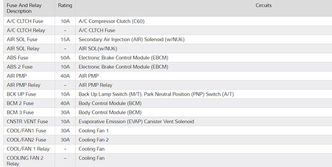

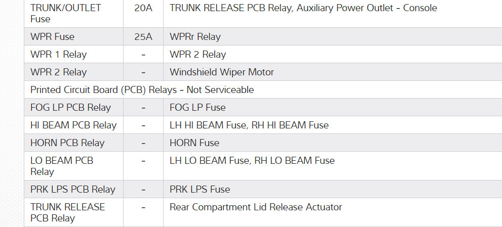

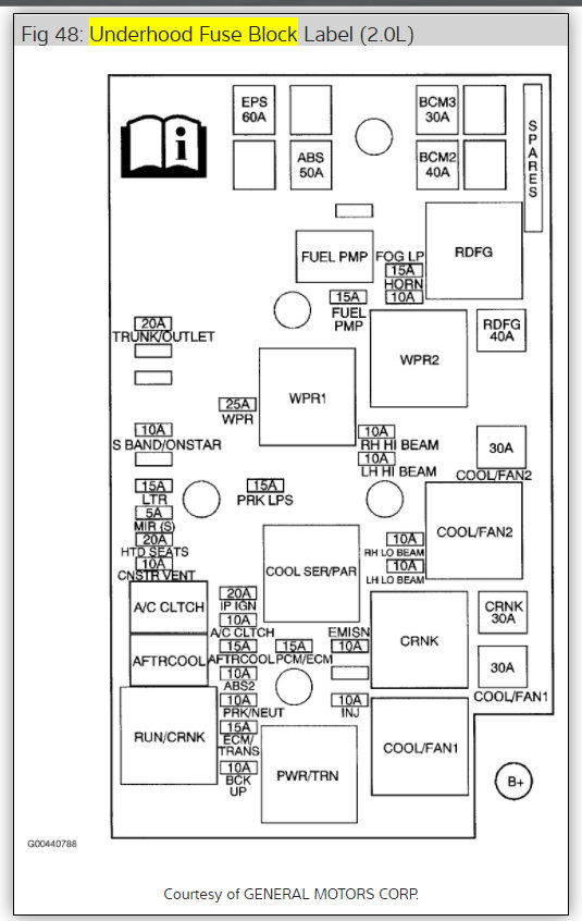

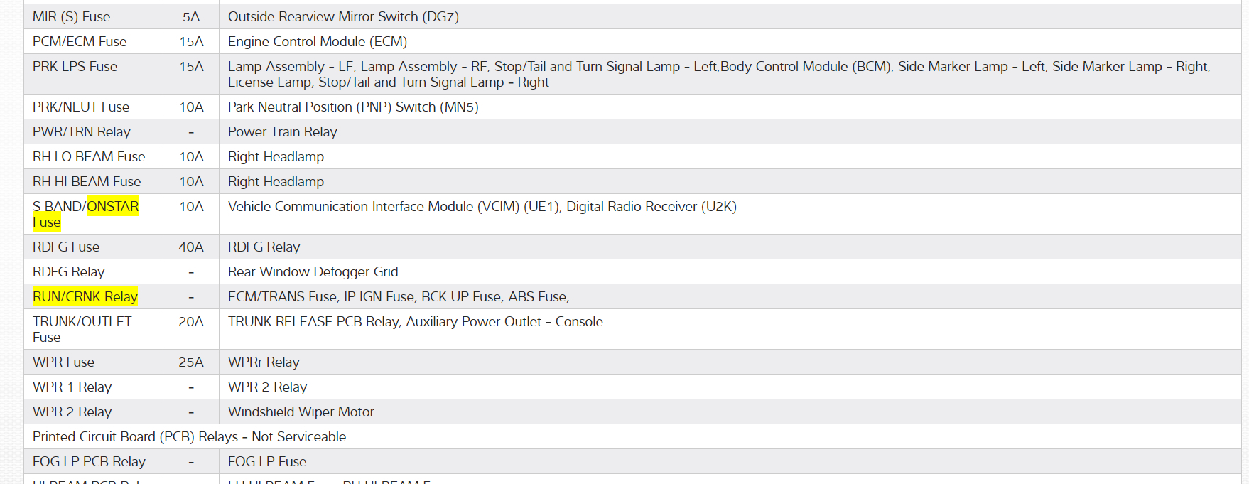

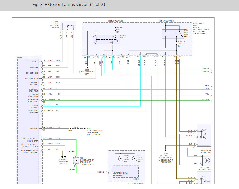

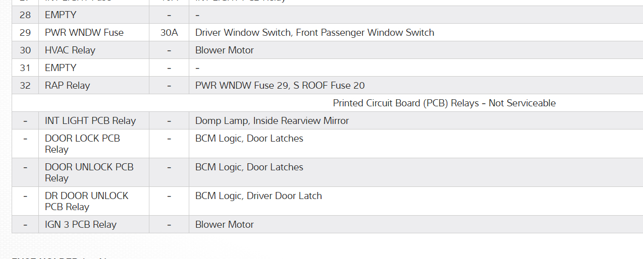

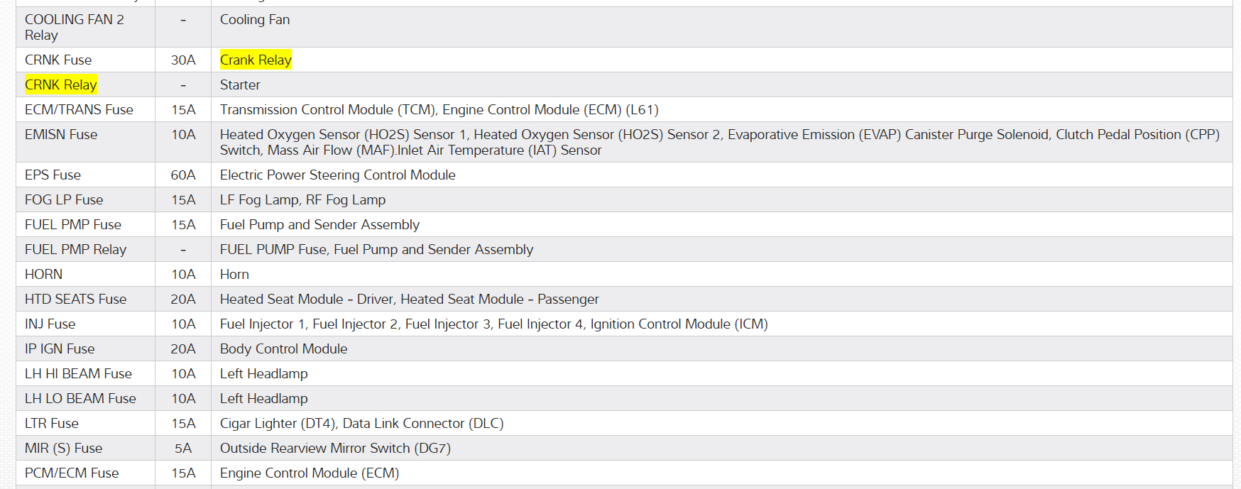

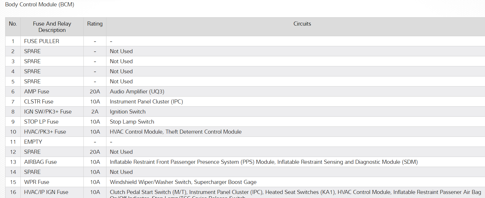

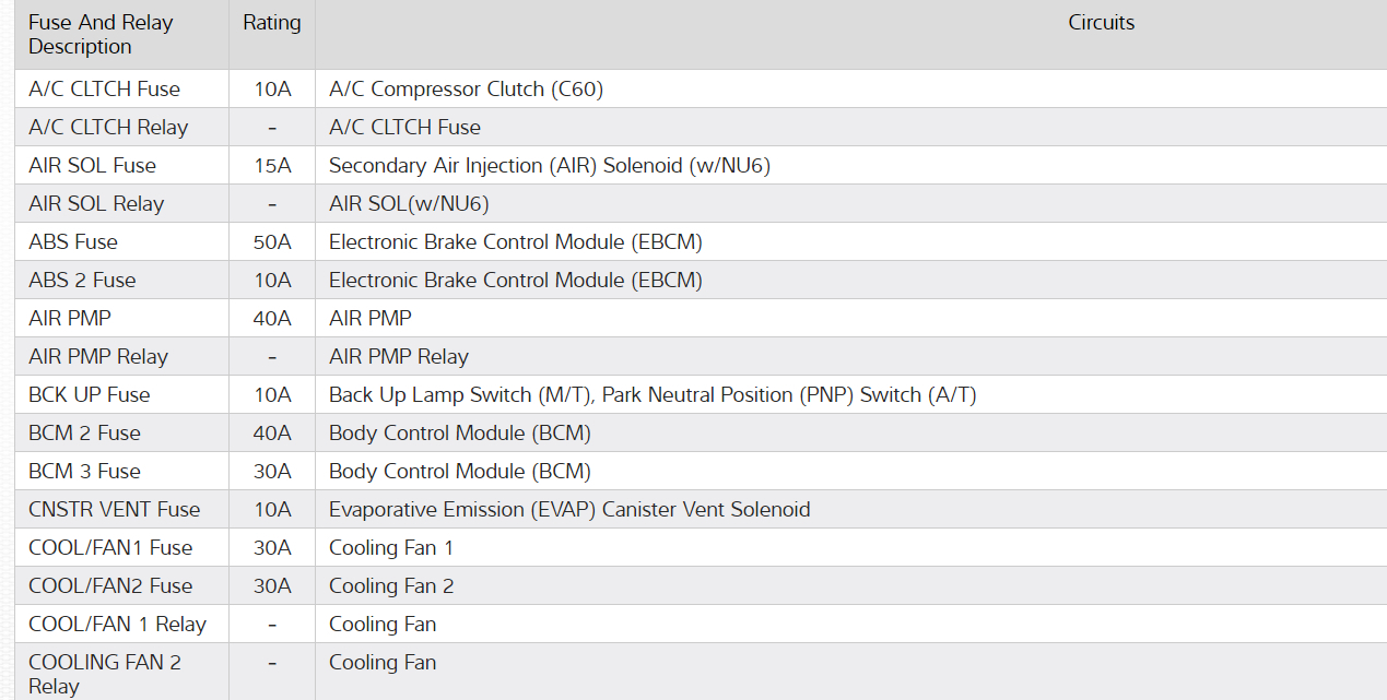

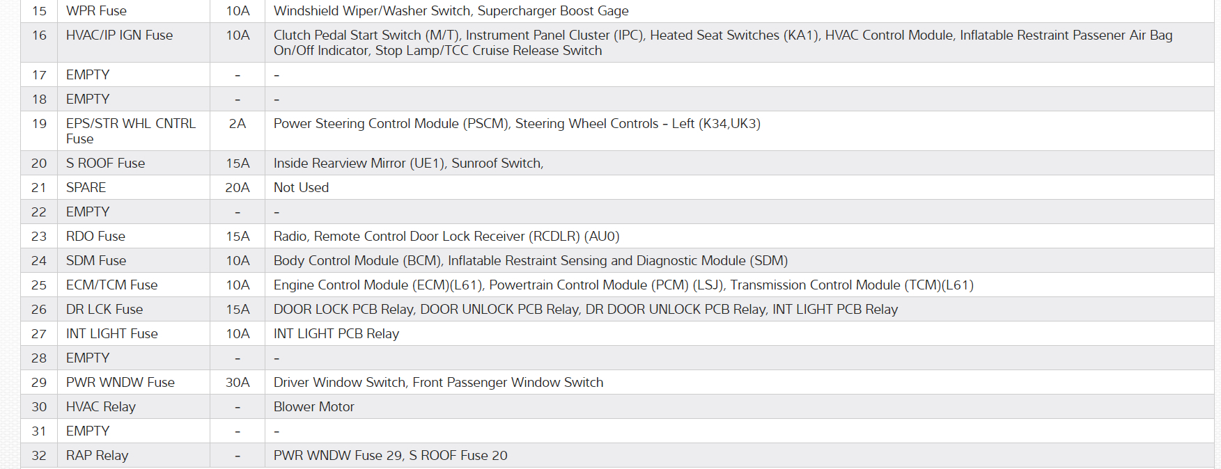

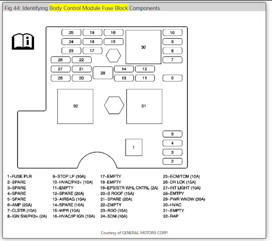

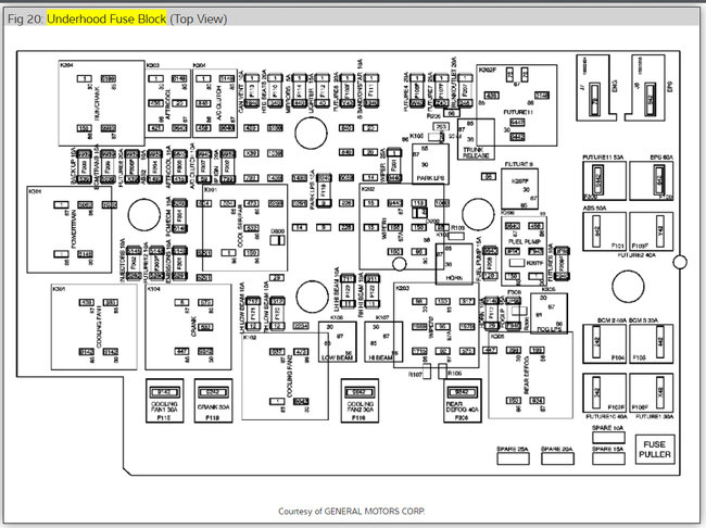

The blinker are controlled by the BCM so I would start by checking the fuses which can cause this issue,. Here is a guide to help you with the blinker wiring diagrams so you can see how the system works and the fuse locations as well.

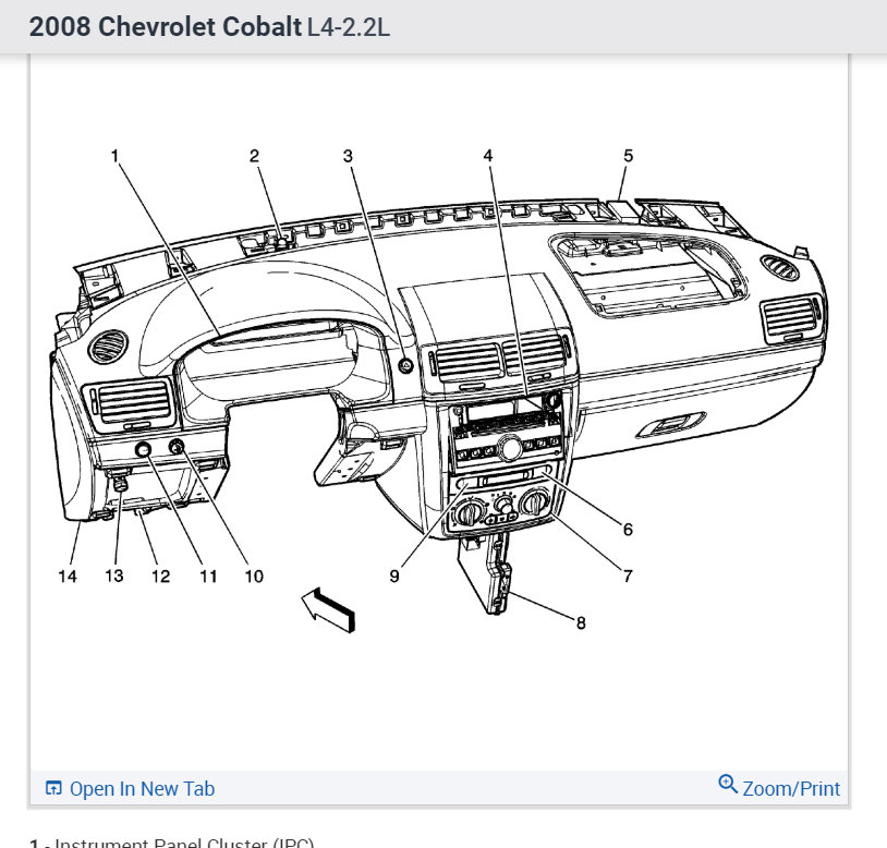

GMTECH
  • 537 POSTS

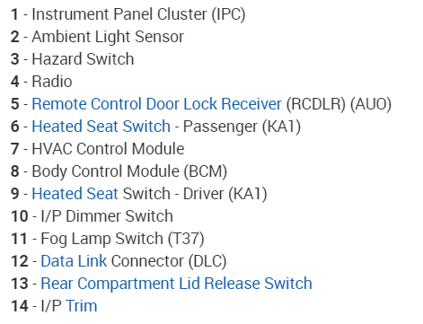

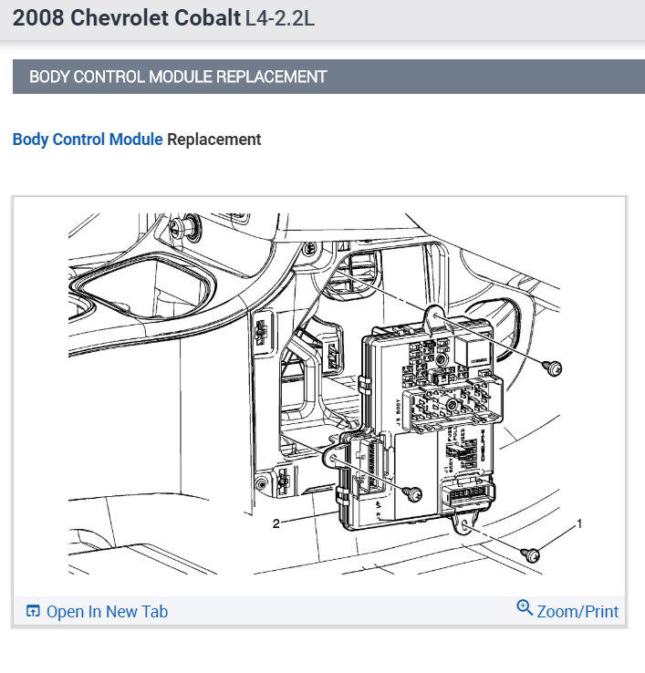

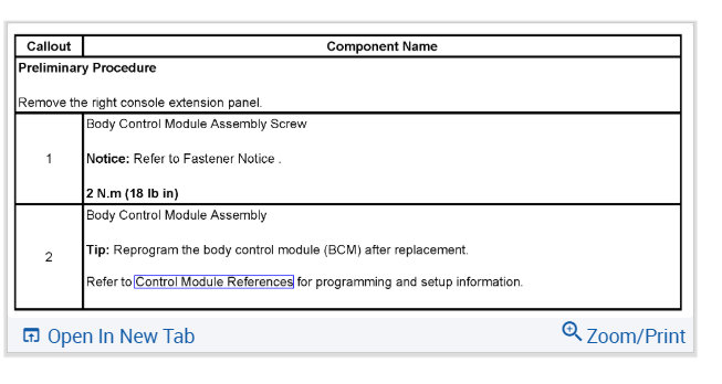

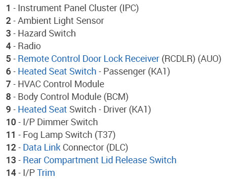

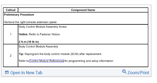

If the fuses are okay the BCM needs to be replaced here is the location and the instruction on how to replace it below.
Body Control Module Programming and Setup
A new body control module (BCM) must be programmed with the proper regular production option (RPO) configurations. The BCM stores the information regarding the vehicle options and if the BCM is not properly configured with the correct RPO codes the BCM will not control all of the features properly. The Tech 2 software will automatically prompt you with the various RPO's available for the vehicle. Ensure that the following conditions exist in order to prepare for BCM programming:
1. This entire procedure has been reviewed before starting
2. The battery is fully charged.
3. A CANdi module is installed between the vehicle and the scan tool.
4. The ignition switch is in the ON position.
5. The data link connector (DLC) is accessible.
6. All disconnected modules and devices are reconnected before programming.
BCM Programming
Important: Use extreme care when verifying both the VIN and Odometer reading that is set in the service BCM. Once the VIN and Odometer are set in the replacement BCM it is impossible to change them, and if there is a mismatch, the part will be rendered useless.
To setup a new replacement BCM select Vehicle Control Systems, then navigate to Computer/Integrating Systems, once in the Computer/Integrating Systems menu select Module Replacement/Setup and follow the instructions on the scan tool.
If the BCM fails to accept the program, perform the following steps:
* Inspect all BCM connections.
* Verify that the scan tool has the latest software version.
SDM Part Number Learn Procedure
If the SDM is replaced the SDM part number must be learned by the BCM. Using a scan tool navigate to Vehicle Control Systems, Module Setup, Supplemental Inflatable Restraints then select Setup SDM Part Number In BCM. Follow the on screen directions.
Important: After programming, perform the following to avoid future misdiagnosis:
1. Turn the ignition OFF for 10 seconds.
2. Connect the scan tool to the data link connector.
3. Turn the ignition ON with the engine OFF.
4. Use the scan tool in order to retrieve history DTCs from all modules.
5. Clear all history DTCs.

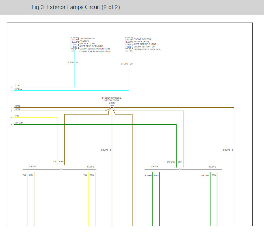

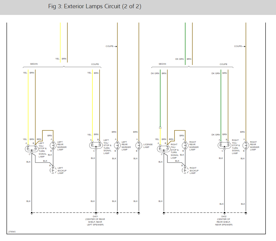

Check out the diagrams (Below). Please let us know what you find. We are interested to see what it is.

It is either the turn signal switch or a short in wiring.
If this just happened, I would think the signal stalk.

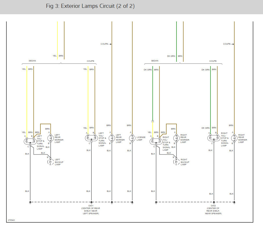

ERNEST CLARK
  • 1,730 POSTS
The flasher circuit is designed to blink rapidly when one of the bulbs in that circuit fails.
Make sure you changed all the bulbs in that tail light housing that doesn't work.
If you are absolutely sure that all the bulbs are good, then look in the wiring or connector for corrosion or a loose wire/connector.

The turn signals are controlled by the Body Control module. About all you could do yourself is test all your fuses. Beyond that would require some real expensive equipment and electrical knowledge.
