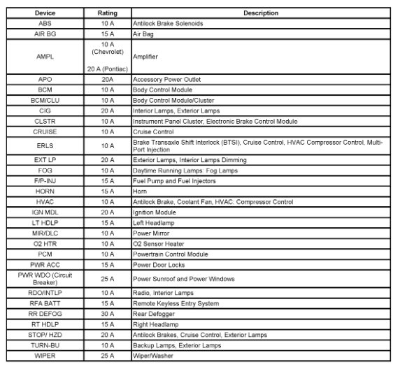

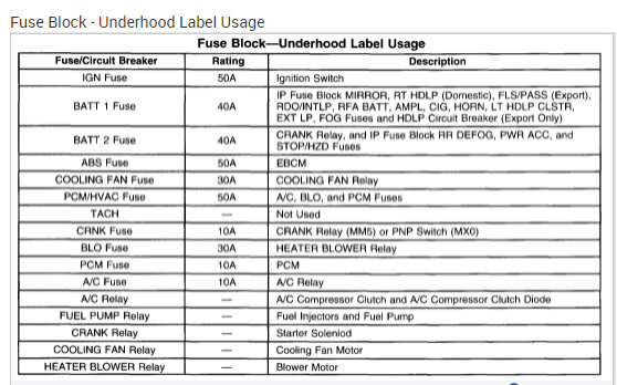

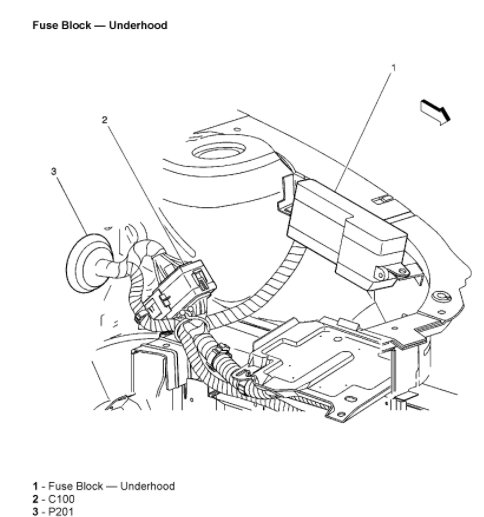

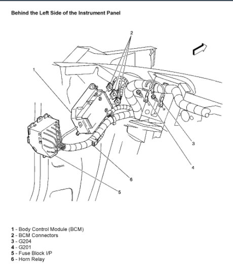

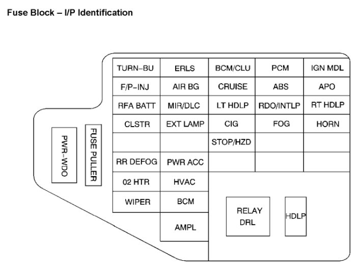

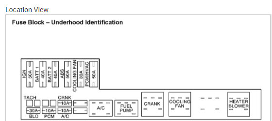

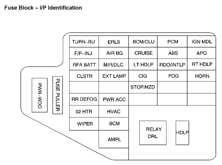

I just bought my car from a private person I was told that the car needed some fuses replaced but I cant find them and I need to know how to check them?

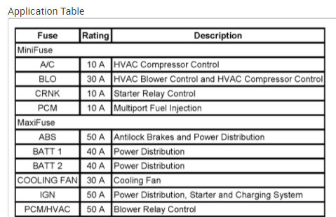

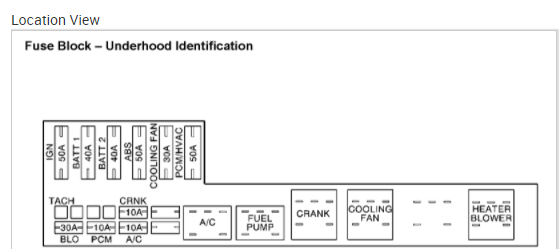

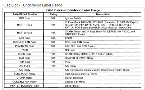

Here is the information you requested. Here are a few tutorials for you to view on how to check and replace fuses:
I've attached pictures below showing the fuse and relay locations on your car. Hope this helps and thanks for using 2CarPros.
