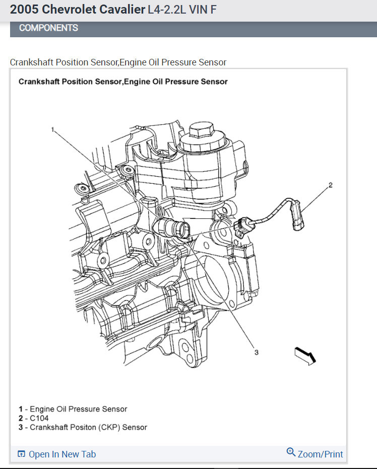

While driving my car feels like it isnt getting fuel maybe... And if im stopped and go to take off it hesitates and then goes. but even if im on the highway going 60 it stalls? what do you think is the problem?

This sounds like a classic crankshaft angle sensor going out but to be sure this guide can help and I have included the crankshaft angle sensor location in the diagrams below so you can change it out.
https://www.2carpros.com/articles/engine-stalls
This guide will help walk you througbnt he sensor replacement with instruction below on how to change yours.
Check out the diagrams (Below). Please let us know what you find. We are interested to see what it is.

Thank you for the guides and advice. I had this problem and got a new sensor from Amazon to fix it. :)
