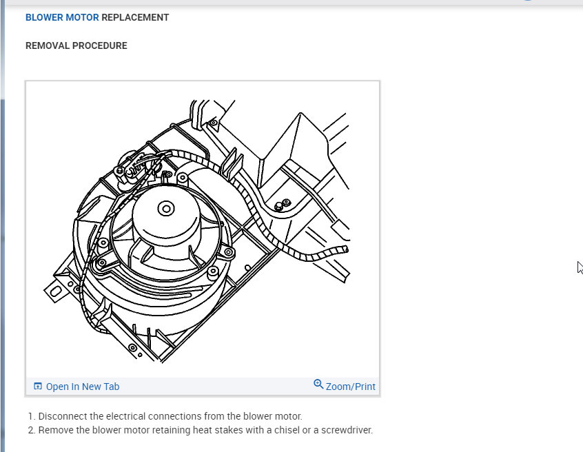

2004 Chevy Cavalier

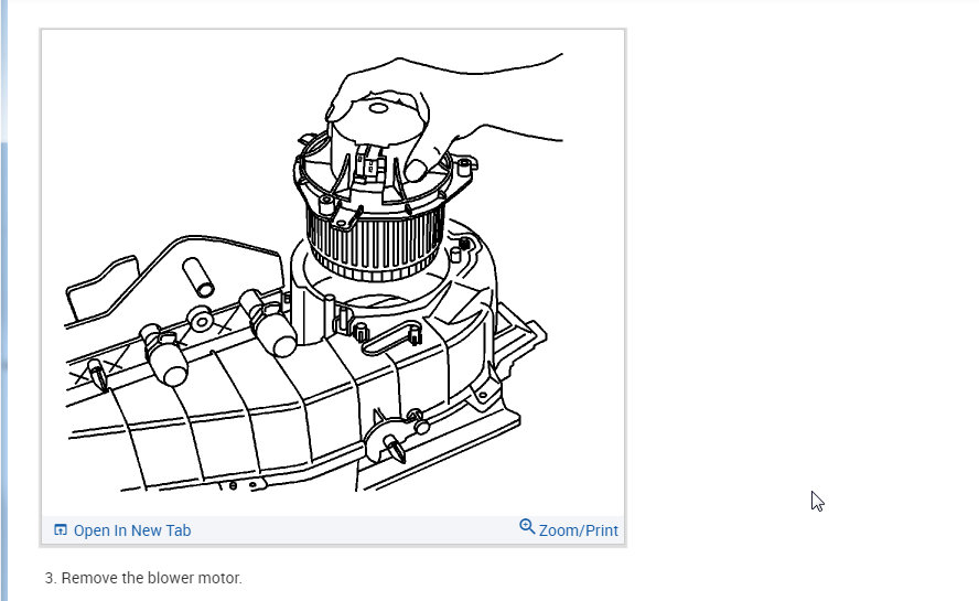

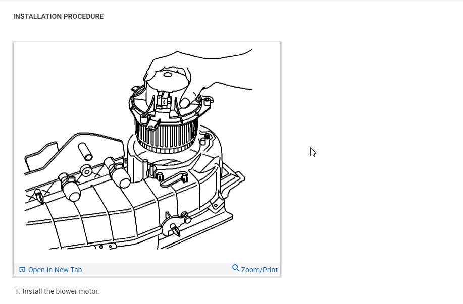

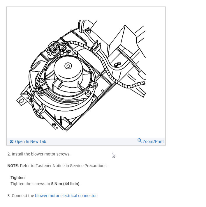

how to remove & install heater motor when there are no bolts holding original motor
Tuesday, August 25th, 2020 AT 5:17 PM (Merged)
BIGJIM79
  • 239 POSTS
There should be a plastic cover that hides the three bolts that hold it in place.
Thanks for that info.
I am attaching the info from the manual in the event someone else needs this detail. Let us know if you need other info. Thanks
