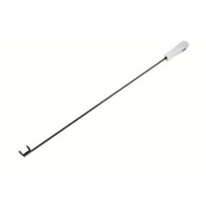

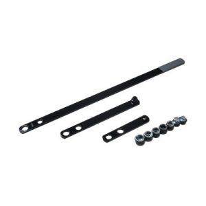

Changing serpentine belt 2.2ohc engine. Looks like I have to remove right tire and fender well parts to get to belt. No way from the top. Any ideas or tricks of the trade. This looks like a real SOB. Steve
Monday, December 17th, 2007 AT 5:32 PM
SERVICE WRITER
  • 9,123 POSTS
Gotta love engineering huh?
There is a serpentine belt tensioner wrench that is thin enough to get in there to release the tension, there is a also a tool that is a long thin screwdriver type of tool except that it has a hook on the ned.
https://www.2carpros.com/forum/automotive_pictures/30961_mst110_1.jpg
https://www.2carpros.com/forum/automotive_pictures/30961_sb579_1.jpg
