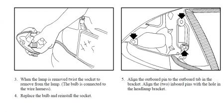

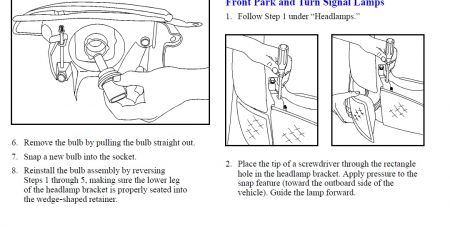

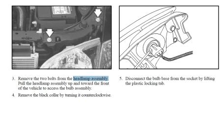

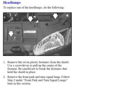

How do you change the headlights
Sunday, May 23rd, 2010 AT 1:55 PM
INTERNETMECHANIC
MECHANIC
700 POSTS
I found this info. If you have an owners manual, the procedure is there?
