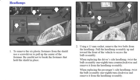

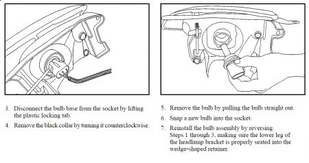

My question is. How do I change a front headlight?
And if you have pictures that would be great if not it's still okay because right now I don't have anything right now.

Hi, your owners manual may have this info.
