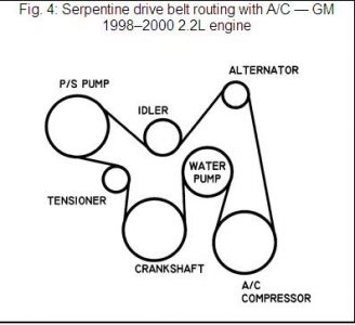

need to know easiest way to thread serpentine

I'm not sure of engine litre size? I usually start at the hardest to reach place first, if that is at the bottom, start there.
