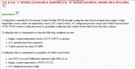

I have a 98 chevy cavalier z24 2.4 litre. I have replaced all sensors and flushed the radiator, bought a new resevoir, replaced therm. Fan relay and my fan won't click on when the temp. Gets hot. The only time my fan comes on is when my AC is on. When I turn my car off coolant comes out of the top of the resevoir thru my cap. I live in AZ and it is getting hotter. I need help. Any suggestions on what it could be. My car is overheating and getting horrible gas mileage.

Coule be the computer. Double check the engine coolant temperature sensor also see below

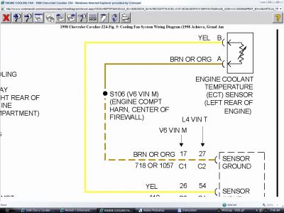

I have changed the engine temp. Control sensor. How can I find out if its in the computer?

Check the CTS signal input to the computer see above

Disconnect the wire harness connector from the CTS and measure the resistance of the sensor with a high input impedance (digital) volt-ohmmeter. The resistance should be less than 1000 ohms with the engine warm

I have tested my ECT signal and it is working properly. I got a reading of 453 when it was at normal running temp, and it stated at 904. How do I test my computer now.

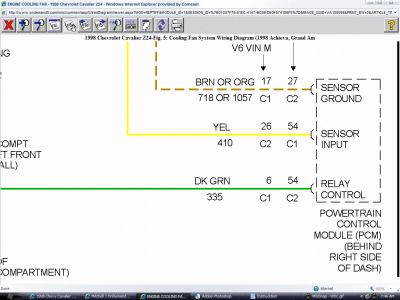

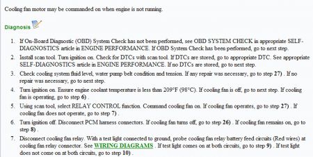

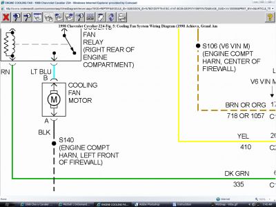

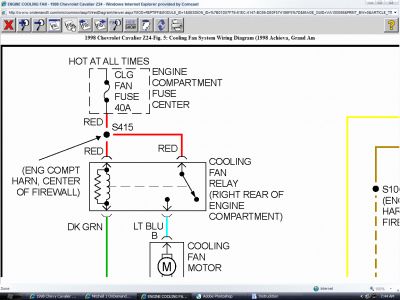

https://www.2carpros.com/forum/automotive_pictures/62217_Fan_Relay_1.jpg
https://www.2carpros.com/forum/automotive_pictures/62217_Operationa_1.jpg
https://www.2carpros.com/forum/automotive_pictures/62217_Testsa_1.jpg
https://www.2carpros.com/forum/automotive_pictures/62217_Testsb_1.jpg
https://www.2carpros.com/forum/automotive_pictures/62217_Testsc_1.jpg
https://www.2carpros.com/forum/automotive_pictures/62217_Testsd_1.jpg
https://www.2carpros.com/forum/automotive_pictures/62217_WDa_1.jpg
https://www.2carpros.com/forum/automotive_pictures/62217_WDb_1.jpg
https://www.2carpros.com/forum/automotive_pictures/62217_WDc_1.jpg
https://www.2carpros.com/forum/automotive_pictures/62217_WDd_1.jpg
Sunday, June 15th, 2008 AT 7:04 AM
SHERRYRENEE
  • 6 POSTS
Thank you so much for all the information. After reading much of it I understand more why my fan won't click on. I guess engine temp isn't getting to 223 F. I am going to test everything you have sent me information on. I will get beck to you with the results. Again thank you so much for all the help.
